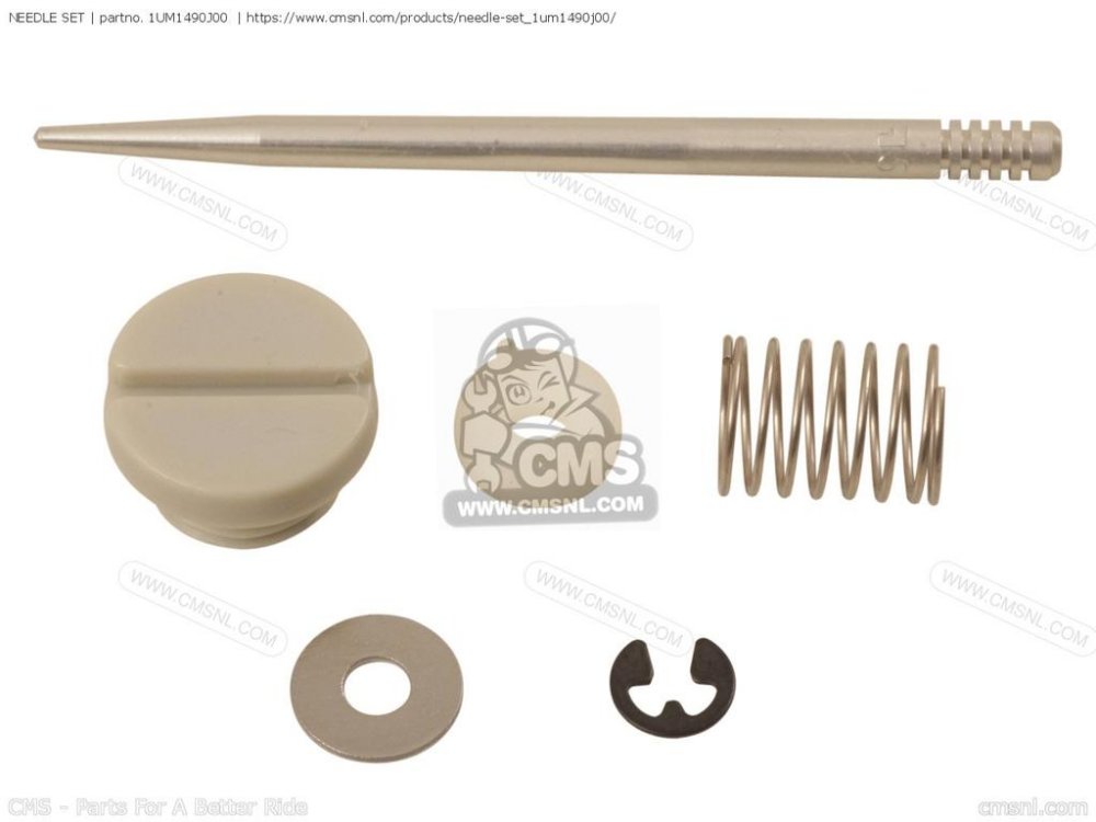

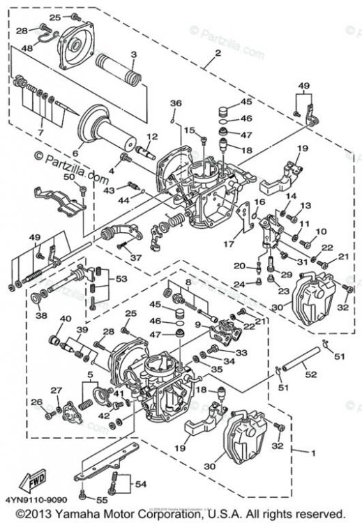

  11. First of all, proper nomenclature is important to avoid confusion, for all parties. There is but one "needle valve" on the Venture carbs. That would be the float valve, and it does not have a spring (or screw). Since you say you pulled the diaphragms and "undid the screw holding the needle valve", I suspect you are looking for the coil spring under the white plastic screw on the piston assembly. But if your "needle valve" is really the PILOT SCREW or air/fuel mixture screw, then yeah, there is supposed to be a small coil spring applying tension to the pilot screw to prevent vibration from changing its setting. But again, I am confused, because one does not have to remove the piston diaphragm to access the pilot screw. Which spring are you missing? This spring on the PILOT SCREW? This spring on the needle assembly? This spring on the #7 needle assembly on the diagram?

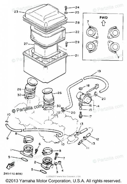

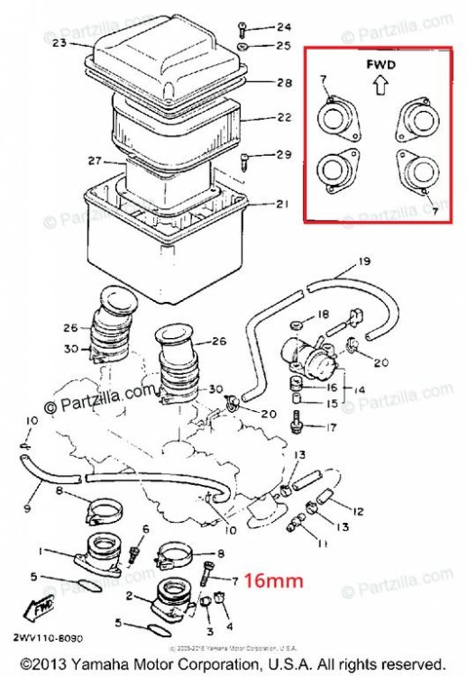

  16. It is a common problem. An inattentive mechanic may not notice the different bolt lengths. AND the same inattentive mechanic when looking at the parts diagram sees the longer bolt (91317-06020)going into the threaded hole in the head at the exact location that the shorter bolt (91314-06016) should go. The parts diagram is wrong, but if the mechanic were to look at the parts LIST, he should see that there are just two 16mm bolts (#7) and the list correctly assigns the shorter bolt to its proper location. But the drawing does not!
  17. When you reassemble, just insure that the shorter bolts go where they are supposed to go. Clean the threads on the short bolts and in their respective hole with degreaser and then apply a very light coating of sealant on the bolt before mounting. Don't use very much sealant. Excess sealant could be pushed into the now open oil gallery.
  18. Were there shorter bolts (16mm long) in those holes (upper bolt on #2 cylinder and upper bolt on #3 cylinder)? The rest of the bolts (quantity 6) are 20mm long.
  19. Don't worry about what kind of lube to use on the O-rings at the base of the carb joints/holders/boots. As long as the head surface is clean and defect free, and the O-rings are new and proper, dry assembly is OK. The TOPS of the joints (where the base of the carb fits) can be simply lubricated with WD-40, Vaseline, lithium grease, etc. Not that critical. Lubrication at that location just makes carb insertion easier.
  20. None of the bolt holes should seep oil. If any do, it is because the incorrect bolt was installed previously, thus breaking into the cam oil gallery.
  21. Generally, sealant is not recommended on any O-ring. Light compatible lubricant is acceptable. When assembling the carburetor "joints" onto the cylinder head, please note that the mounting bolts are not all the same length. Putting the 20mm bolts into the wrong location will cause the long bolt to break through into the cam oil gallery.
