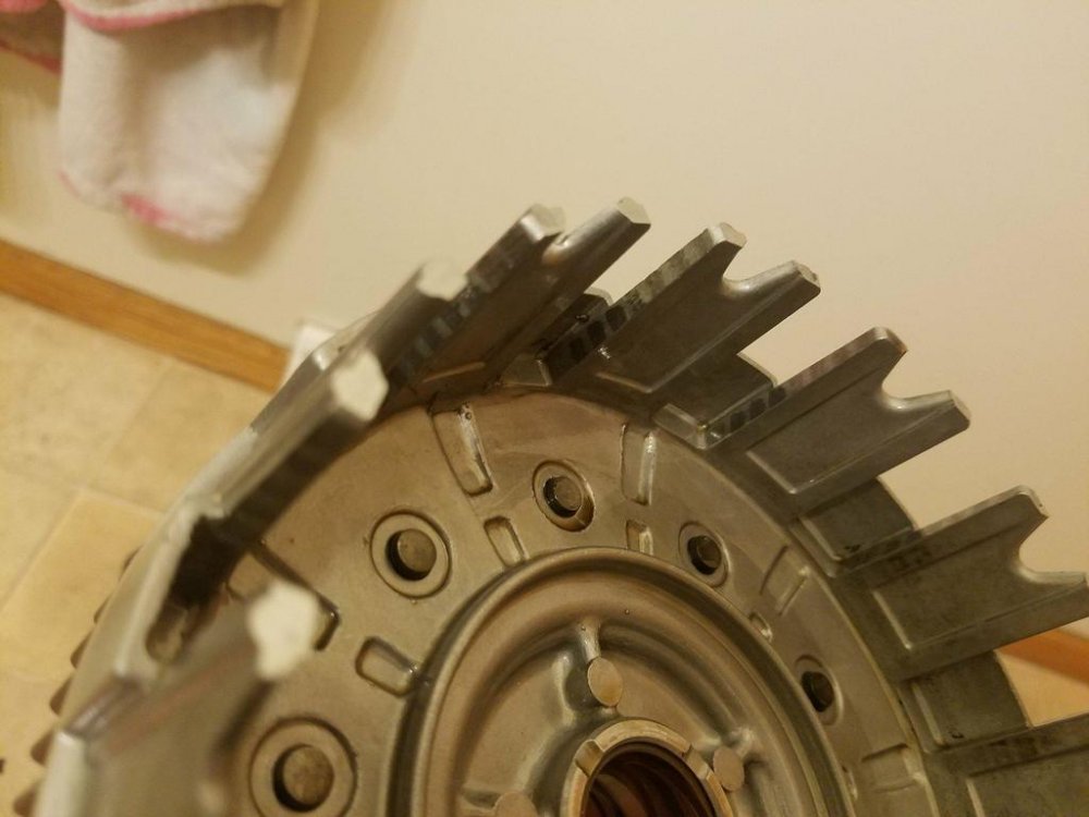

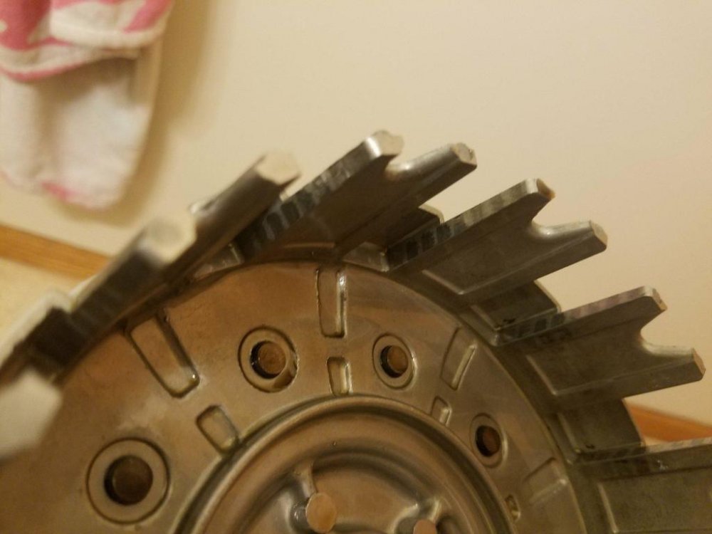

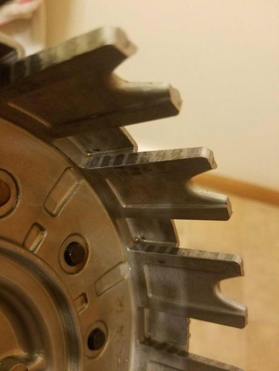

There's a few pictures of the old basket! Looks like it coulda made for a possible chattery clutch? I ran my nail up and down a few of the surfaces and I there were a few spots that are going to need attention. I decided to go ahead with putting the new basket in instead. The new one had a little notched part on one of those fingers so I sanded it out as well. I got it all installed and its mayyybbbeee(?) a little better. Still sort of tries to roll in gear, maybe not as bad. I'm gonna keep trying to work air out of the clutch hydraulics. The only other thing I can think is that the Skydoc clutch upgrade kit eliminates a shim, a retainer wire, and "half friction disc" at the back of the clutch basket and in place substitutes another those three things with a full friction disc. I guess its to reduce the friction zone of the clutch? Would that possibly eliminate some of the precious clearance in my clutch? I've been tempted to buy a new half friction disc, retainer wire and digging the old shim (spacer) out of the trash and trying that
