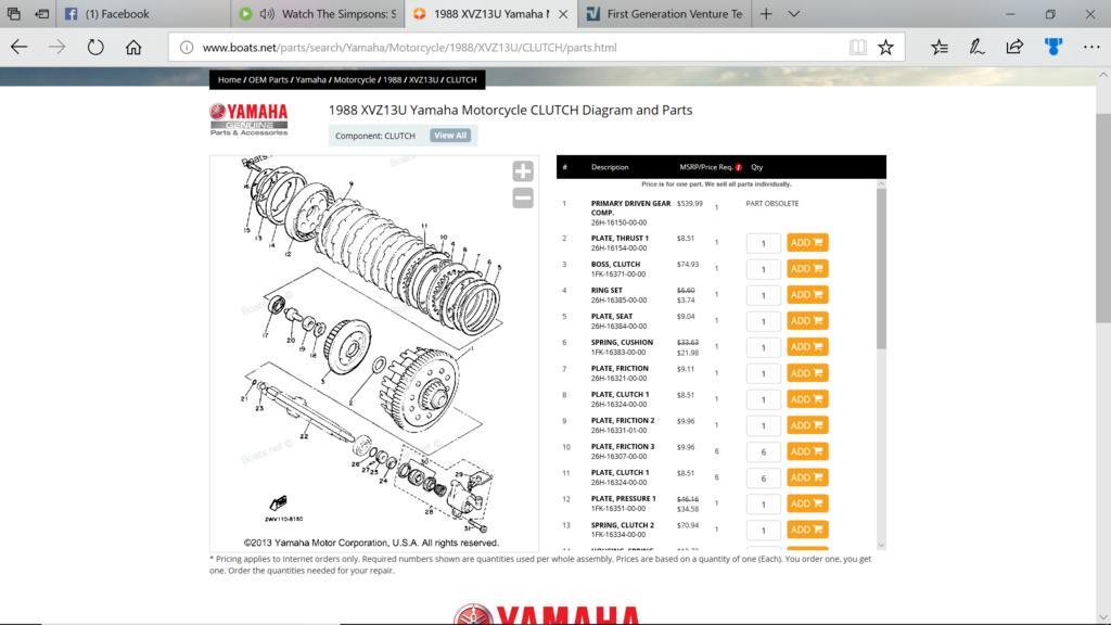

There's a few pictures of the old basket! Looks like it coulda made for a possible chattery clutch? I ran my nail up and down a few of the surfaces and I there were a few spots that are going to need attention. I decided to go ahead with putting the new basket in instead. The new one had a little notched part on one of those fingers so I sanded it out as well. I got it all installed and its mayyybbbeee(?) a little better. Still sort of tries to roll in gear, maybe not as bad. I'm gonna keep trying to work air out of the clutch hydraulics. The only other thing I can think is that the Skydoc clutch upgrade kit eliminates a shim, a retainer wire, and "half friction disc" at the back of the clutch basket and in place substitutes another those three things with a full friction disc. I guess its to reduce the friction zone of the clutch? Would that possibly eliminate some of the precious clearance in my clutch? I've been tempted to buy a new half friction disc, retainer wire and digging the old shim (spacer) out of the trash and trying that -

You know Tim, I think you might be a genius. I never looked at the basket when I had it all apart. I was sort of just following the directions in the tech section but if I had a half a brain I woulda run my finger along to see if it was smooth! That would explain allot too! I'm going to look first thing when I get home! I also happen to have a brand new clutch basket that was supposed to go in my RSV before I wrecked it. If my old one needs work I could probably just throw that other new basket in right? I mean if I have to do sanding on the old one I'll have to take it out anyways right? -

Okay so here's where I'm at now basically. After taking the clutch apart two more times, I found out that that Hollow nut needs to go where the hollow part is towards the inside of the motorcycle or else the inner basket can move in and out. It doesn't sit tight I had it right the first time but I took it apart and switch it out to try it. After that I bled the piss out of the slave cylinder and I still think I must have just a tiny bit of air in there because it's still a little hard to shift and hard to put in neutral it's not nearly as hard to hold in one place but I must still have some tiny microscopic bubbles of air in there. I appreciate all the help! -

Alright, so I've got the new slave in. Bled it and it is better, though it still tries to roll while in gear. Not as bad, but you can hear it labor the motor as well. I think I'm going to let it sit overnight and let the remaining air bubbles sort of settle down and hopefully form into less, but bigger air bubbles and first thing tomorrow I'll try to as gently as I can, re bleed the clutch. I read that the reason skydoc replaces the half friction disc, wire and shims is to reduce the friction zone of the clutch. Had I known that before I installed the clutch, I certainly wouldn't have done that mod, and sprung on the half friction disc and new retainer wire. If this doesn't do it then I guess I'm tearing into the clutch to see if I've got something stuck between one of the clutch plates or friction discs. This is kind of disheartening as its 80 today -

I pulled the slave out and messed with it some because I rebuilt that last fall and it always seemed like I had a touch of air in it. I put a little hand pressure on it and pulled in the clutch lever and noticed the slave leaks slightly under pressure, so I'm assuming there's the culprit. I imagine with the old, weak spring, and the noticeably thinner friction plates from being worn, I could put it in gear and it wouldn't roll. I mean I could maybe, just barely, barley notice it before but With all the new stuff in it, Its just not quite clearing it. Got one ordered in from boats.net and I'll let you guys know if this solves it for me!
