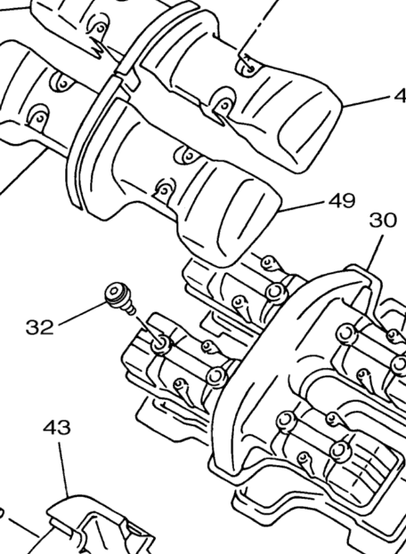

  8. Only problem I had was parts web site said my 2012 had different bolt washer assembly(bolt with washer) than @XV1100SEs 2009 that takes just replacement washer. So when I took off valve covers they were identical to his. The washers that came with my bolts were smaller in width across where they sit on cover but @Marcarl said they cover enough of the hole so should be OK. Will keep an eye on them the next few rides and if they leak I will have to order wider washers.
