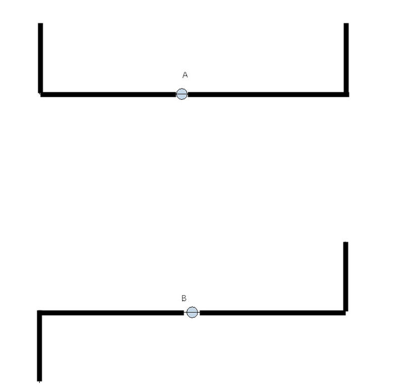

We're redoing our pontoon boat and I have a question about the dipole FM antenna for the radio. The dipole is 41" long but the widest dimension on the console is 28". If I put the antenna in the console it either needs to be cut or folded. In the old console it was shaped like figure A . This is looking down. It seems to me that "B" would be a better solution. I could stretch it out straight below the floor but I assume all the aluminum structure down there would create worse problems than bending or cutting it. Same problem with putting it in a seat - it'd be running parallel to an aluminum sheet. So do I bend it in a U as originally, make the Z shape in figure B, trim it or bend the ends downward? Thoughts?
