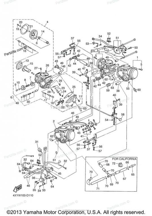

Ok, if you don't know what they are you've got a problem. They need to be opened up to properly clean the carburetor. Part #7 . -
