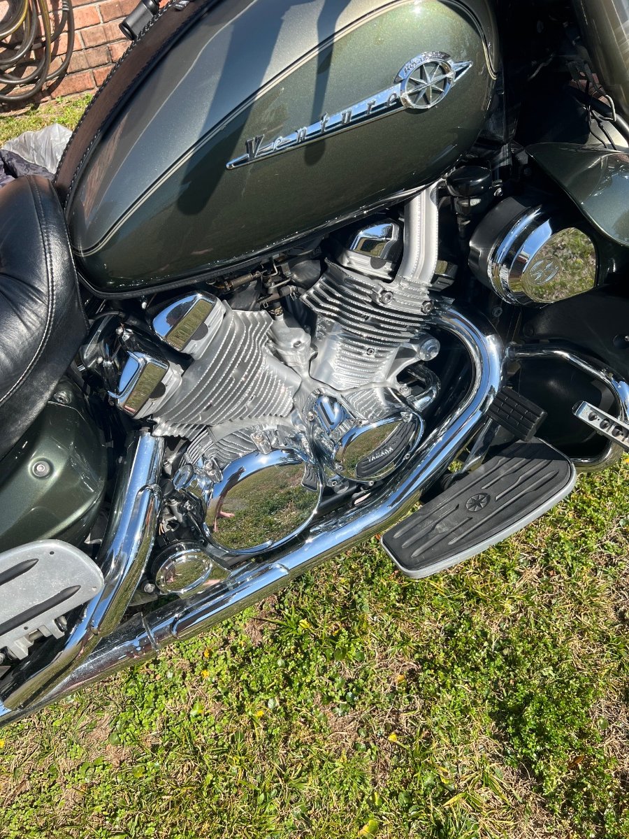

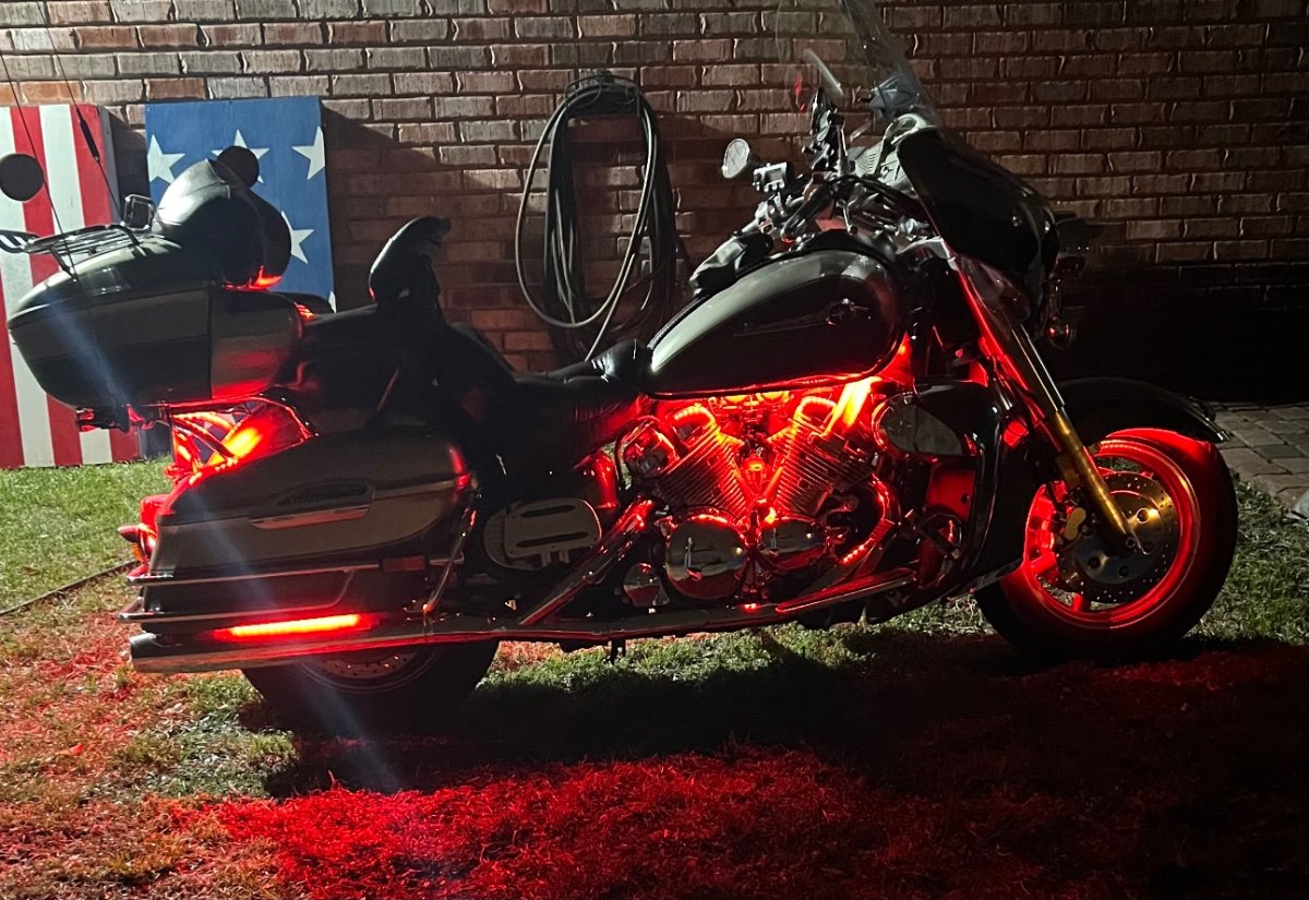

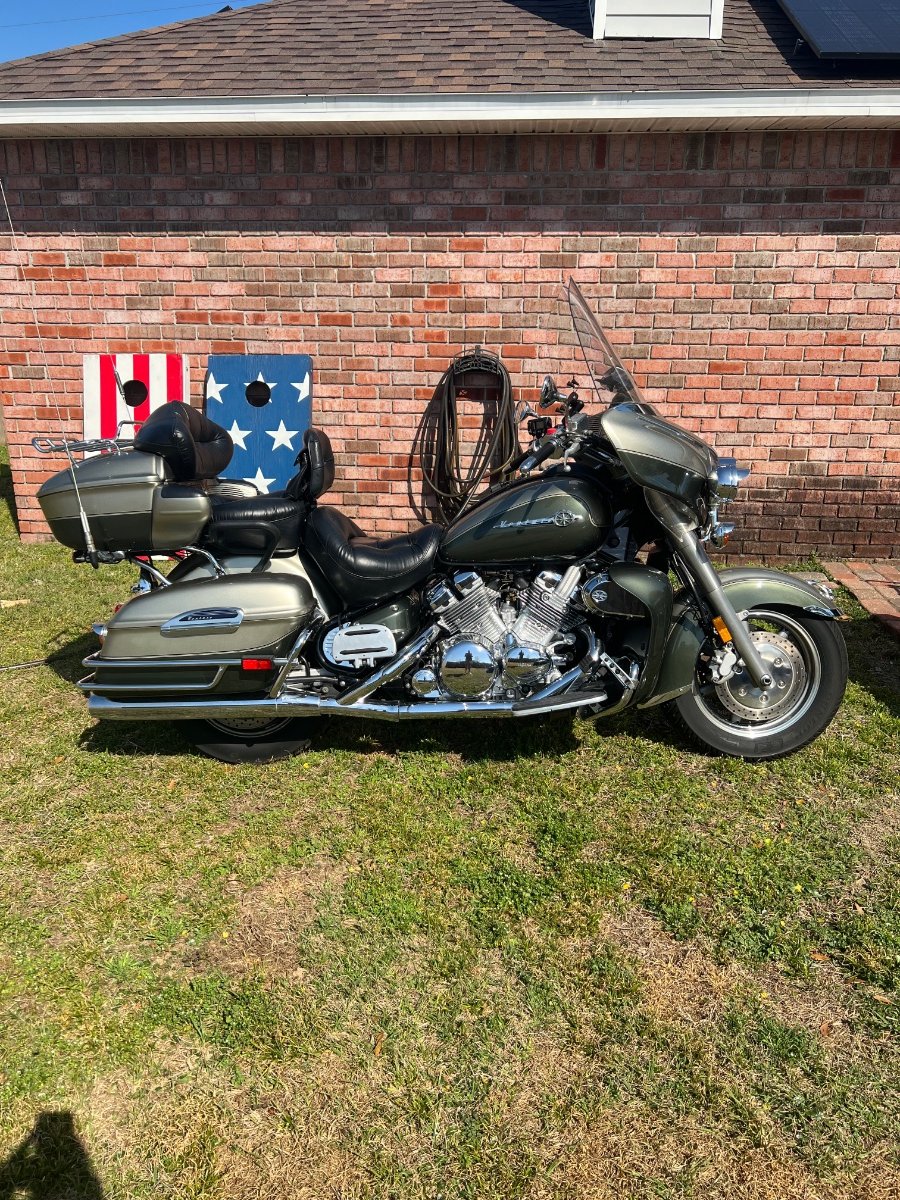

I love the Green. I don’t think I’ve seen any others. Came with a cool lighting set up. Don’t know that I’ll ever really use it but it’s there. Also the first owner had someone diamond cut all the cooling fins. It sparkles in the sun. Again not sure I would have paid to have it done but it’s cool Ogre
