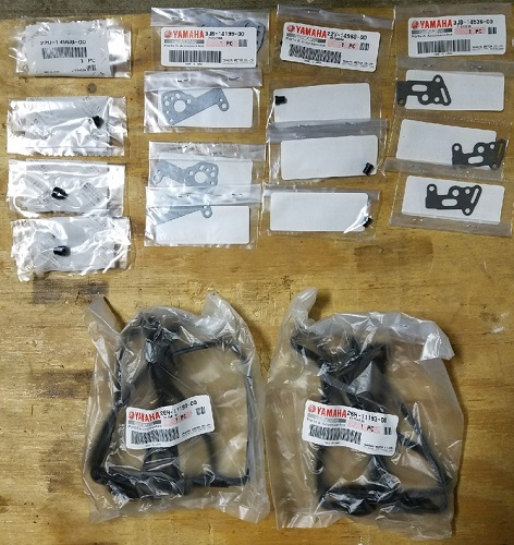

After comparing the new OEM gaskets to the 1 year old chicom gaskets, there is no doubt whatsoever that the chicom gaskets are the reason for my leakage! The OEM gaskets are nearly twice as thick as the cheapo gaskets and ribbed differently. I am confident that the new gaskets will solve my weeping head cover problem. -
Santa brought me my Carb parts and head cover gaskets! Did anybody else get Venture Parts for Christmas this year?

So, I got the new head cover gaskets and carb parts in the mail today But I'm not allowed to open them till Christmas:(. Listen, that's the deal I made and I'll hold up my end of bargain! That didn't stop me from pulling the necessary plastics, yanking the carbs and getting the head cover bolts loosened up this evening. My question is this: Does anyone find it necessary to use a gasket sealer on the head cover gaskets? I have always used HiTack to "glue" the gasket to to the cover for ease of installation but I've never used anything between the gasket and the head on any of my bikes. The reason I'm replacing the gaskets is because the new(chicom) gaskets I installed last winter after doing the valve adjustments have leaked horrendously from day one. I went through nearly 2 gallons of oil this summer. The new gaskets from Partzilla are OEM, Yamaha gaskets. Can I expect them to seal up without any help? The 30+ year old gaskets I tore off last winter did not leak at all.

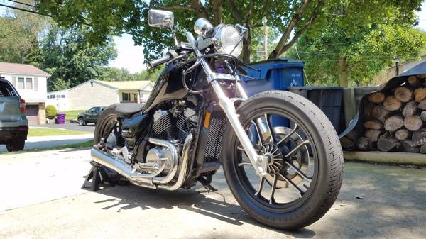

I've entered into a trade deal with a fellow I found on craig's list. He's got an '86 Honda VT500c Shadow that he's bobbed and a spare engine that needs a starter clutch up for sale or trade. I have a basket case '81 Seca 750 in pieces and an '82 Maxim 750 in very good condition. The maxim has been my short hop bike for about 5 years and I'm just plain bored with it after getting my Venture. I offered both XJs in trade and he accepted pending personal inspection or last minute cold feet so the trade is done deal, just getting the logistics together and transporting both bikes and spare parts about 100 miles may take a little time and planning. Here's a pic of the Honda Bobber What do y'all think?
