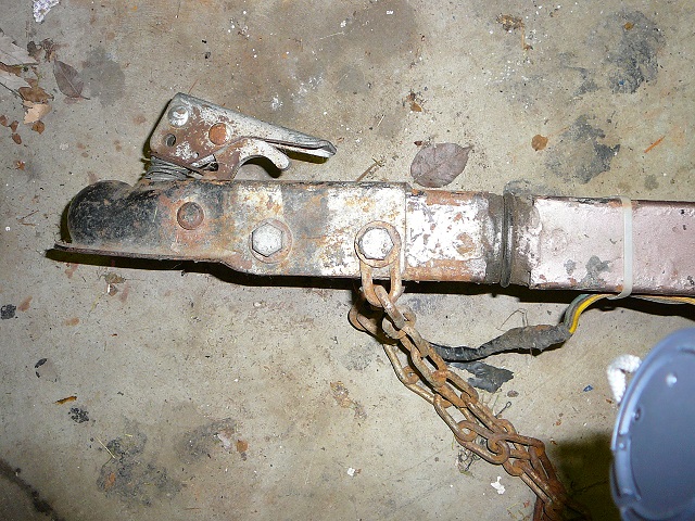

FreezyRider Posted July 18, 2014 Posted July 18, 2014 Hey Joe, Welcome back! I did the same thing about 5 years ago to my craftsman leaf/grass sweeper and craftsman wagon that I pull behind the four wheeler. Had to because it kept bending the tongue. I might use the setup for something less than 200 lbs. but woudn't trust it with my +400 lb. camper. The threaded part is 5/8" but the solid portion only 1/2" and it's not hardened. The other thing I'd worry about is how many degrees of motion there is when you pull into a steep driveway. Haven't had time to measure yet, but i don't think it's as much as a standard ball and hitch.. It definitely works on the four wheeler on the lighter stuff! The threaded shaft on mine is 1 1/8 inch, and the pin hole in the eye is 3/4 inch. I pulled about 350 lb last weekend for over 500 miles without a problem. Think about this...the shank on your hitch ball is likely either 5/8 or 3/4...I've seen both sizes in use on m/c hitches. The diameter of the ball is not the weak point at all, but the shank size is. At least on the ball end. In addition, my coupler was bolted on to the tongue of my trailer using 2 bolts, which are 3/8 diameter. There is likely the weakest point on a normal hitch. I have full confidence in my setup when it comes to pulling 4, 5, or even 600 lbs...much more than I would ever want to pull. As far as the tilt angle, I don't see an issue with it. I have gone up some pretty steep driveways with it so far and haven't felt any problems. Time will tell. Good to be back, thanks for the welcome! Joe
CaptainJoe Posted July 18, 2014 Posted July 18, 2014 (edited) The threaded shaft on mine is 1 1/8 inch, and the pin hole in the eye is 3/4 inch. I pulled about 350 lb last weekend for over 500 miles without a problem. Think about this...the shank on your hitch ball is likely either 5/8 or 3/4...I've seen both sizes in use on m/c hitches. The diameter of the ball is not the weak point at all, but the shank size is. At least on the ball end. In addition, my coupler was bolted on to the tongue of my trailer using 2 bolts, which are 3/8 diameter. There is likely the weakest point on a normal hitch. I have full confidence in my setup when it comes to pulling 4, 5, or even 600 lbs...much more than I would ever want to pull. As far as the tilt angle, I don't see an issue with it. I have gone up some pretty steep driveways with it so far and haven't felt any problems. Time will tell. Good to be back, thanks for the welcome! Joe Joe, I see, you used a category 1 Adjustable Top Link, with a 3/4" Lower Link Pin.... that's a HUGE difference. Quite a bit beefier! I'd definitely trust that with the Bunkhouse! I used a category 0 Adjustable Top Link, with a 5/8" Lower Link Pin on the sweeper and wagon for the four wheeler. Would not, trust that with the bunkhouse...LOL Edited July 18, 2014 by CaptainJoe
