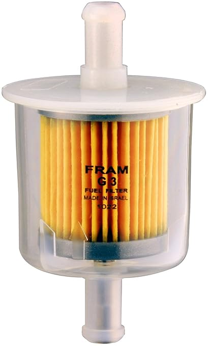

djh3 Posted April 8, 2019 Posted April 8, 2019 Fuel filter is worth a check. They are a PIA to get at, so if your checking it out might as well just change it. I ran one like this Also I just went solid state with a Mr Gasket G 42 fuel pump. Never had to worry about it again.
