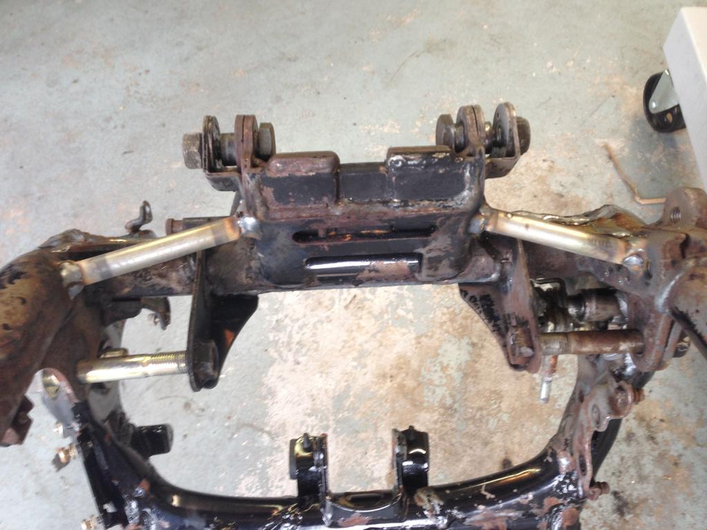

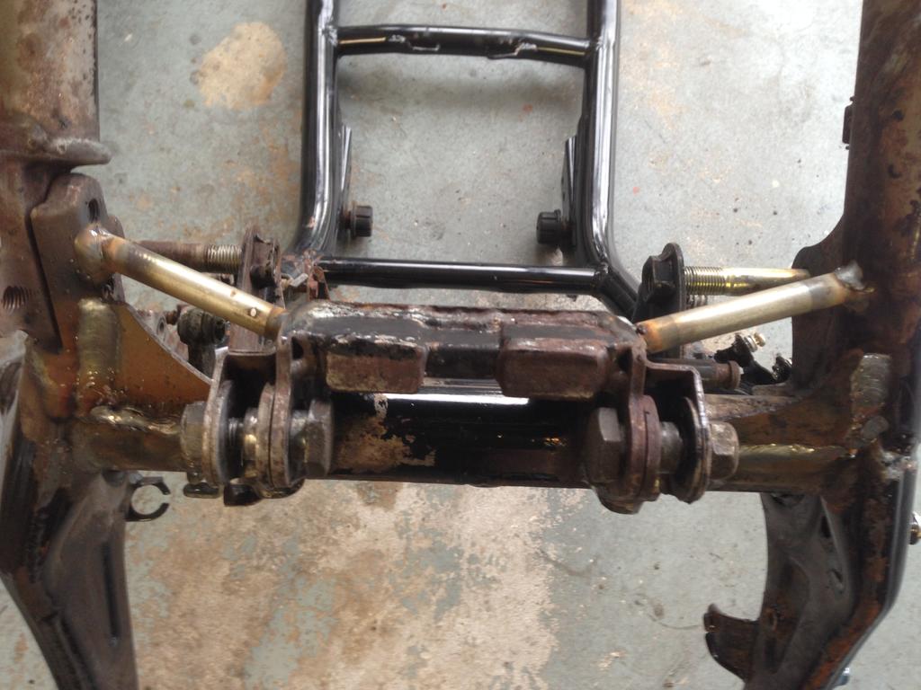

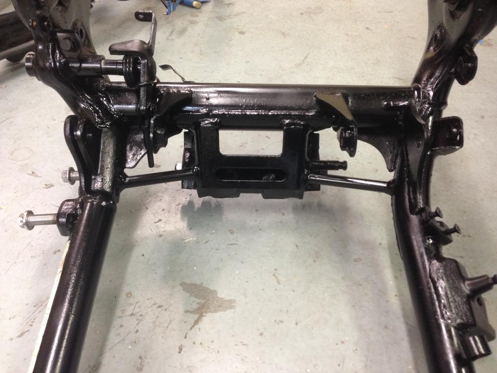

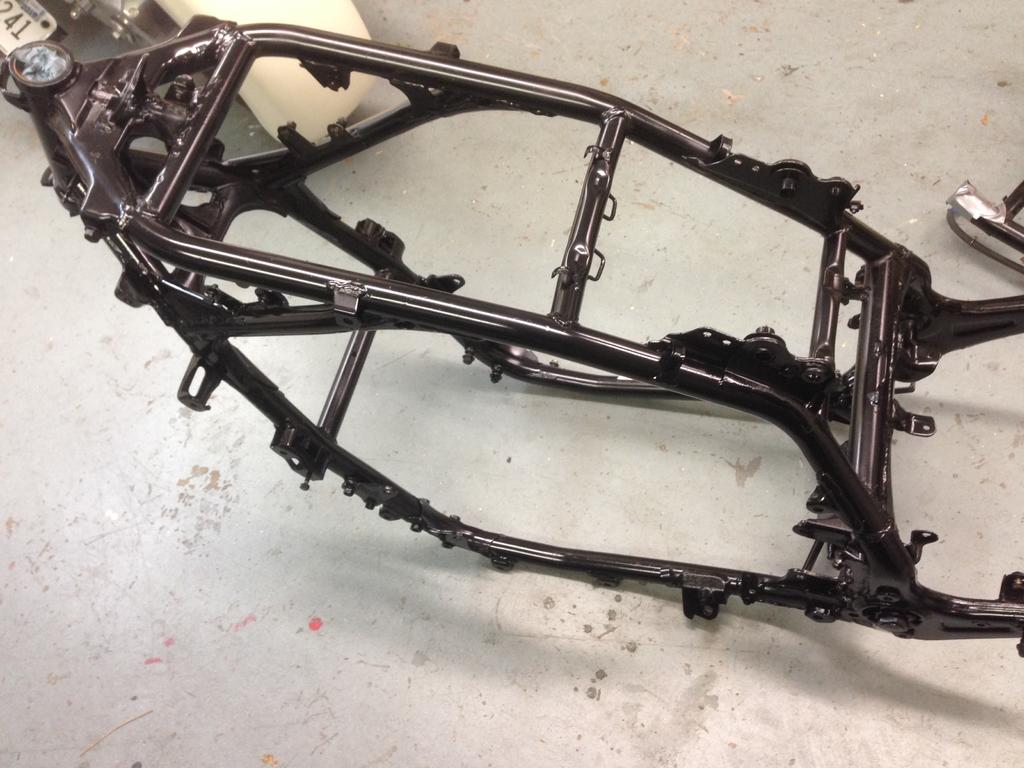

Instead of taking my frame to be sandblasted and powder coated I simply used my wire wheel on drill and then wiped down with prep wipe. Decided to use VHT high heat paint designed for chassis. Covered was good and it also has a built in primer with anti rust. I will hit it with a couple more coats and then attention turns to engine!
