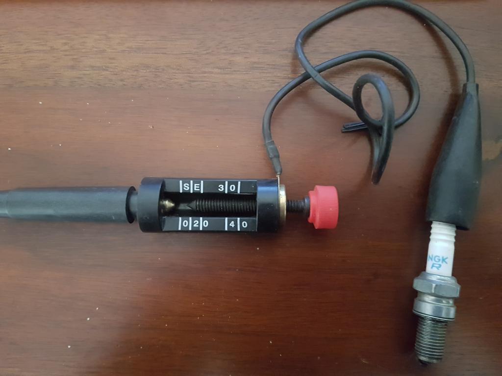

Patch Posted June 29, 2018 Share #34 Posted June 29, 2018 I've been kicking this around much of the day.. Not sure why we haven't asked yet? (likely Carl's fault tho) What is the voltage at the coils? need house voltage to compare Now seems obvious we would like to do a gap test for the secondaries, right? But I got to think about your ride, and wondered if the plugs are bridging to much air? Know what I mean... So have a look if you will because weak coils have little reserve and can miss even with a hot plug. Blue & Video, not sure if there is a question attached to the 5 verses 10? But might be best to start a thread and not distract from OP.. Link to comment Share on other sites More sharing options...

Patch Posted July 4, 2018 Share #41 Posted July 4, 2018 Wow! So what is it that tells you there is a miss on all 4? You mentioned timing light but also that you couldn't track it. The miss is both when the bike is cold or only at operating temperature? If it is all 4, there must be a common link.. So proving it is all 4 is a must. I know 2 ways one uses the old cheap setup for a spark light tester ( still sold at part stores) the other is the gap tester (which can be done with a screwdriver and a ...) if you want instructions on how let me know. Anyways the idea is to run the engine at ideal then increase and maintain rpms by a 1000 till you get to 5000ish allowing 30 ish seconds at each rise to see if you can pin the range or if it's throughout. Be cautious that you don't overheat the old girl.. Link to comment Share on other sites More sharing options...

Patch Posted July 4, 2018 Share #45 Posted July 4, 2018 Ok below is the setup I would use. It isn't expensive and again available at local parts stores. Before I explain the homemade version lets look at some of the results. You certainly have 1 pickup coil that is on the limits for me it is done because she hasn't the speed of the others! Both ing coils are also just above the limits, they are suppose to be below 3! More importantly nowhere have I read the house V or the coil input voltage? For the test and while looking through my shop at stuff you will likely have.. Take a 10" insulated 10ga. wire and strip 1/2" off one side, twist tight with pliers and the other side strip 1" and using your pliers and a star screwdriver make a loop around then twist it with the pliers so its neat and tight, then slip the driver out. The end with the eye goes into the HT boot and the other end - while holding with insulated pliers on the wire shielding, touch that end to the top of the spark plug and start the bike! Just focus on the wire and it proximity to the contact of the plug conductor. 6mm is the minimum air gap that the ignition coil must jump, lets call this a heavy 1/4" before missing! So see how high you can gap it before the miss shows up? Mark that down! Best not try to measure with anything conductive;) Same plug after the above cut the gap to 1/8 +- let her run like that for 30/40 seconds. Does she miss at all? Mark that down as 1/8" test Then shut the bike down and pick you next plug. Try not to run the engine without the plugs firing as we will be accumulating unburnt fuel in the circuit, this might cause confusion. Sun glasses might help you during the test instead of trying to work in the dark. Need I remind you "no pacemakers" around 15000V My guess is that if we see one plug consistently missing on the 1/8" test, it will most likely be the pickup. Patch Link to comment Share on other sites More sharing options...

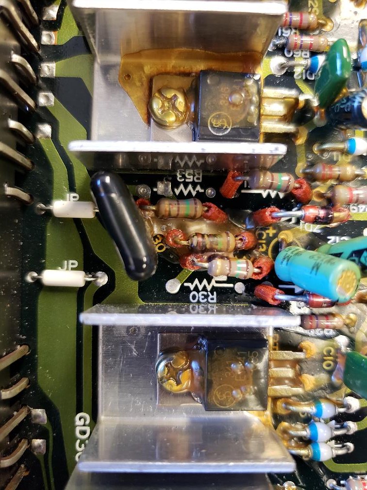

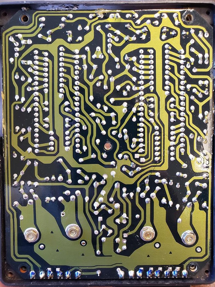

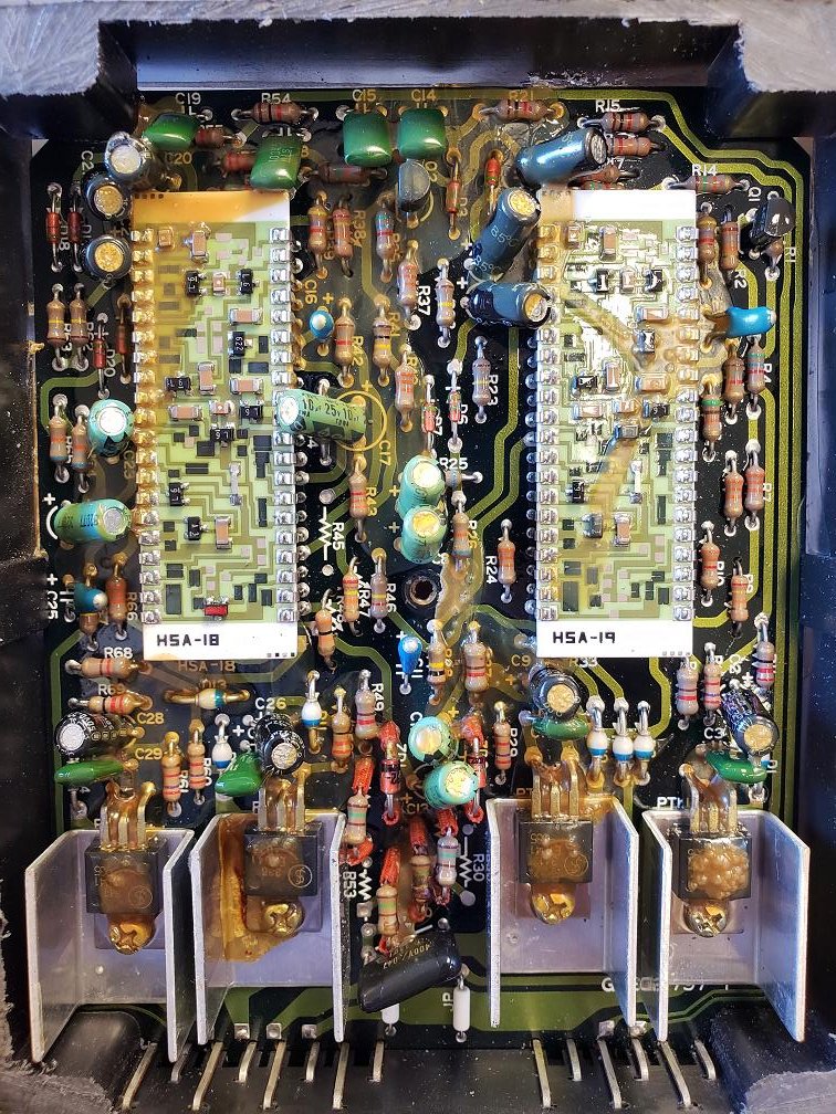

oldfaithful Posted July 8, 2018 Author Share #47 Posted July 8, 2018 This is the latest update. I'd been putting this off in hopes of finding something else. Nevertheless, I removed the TCI and opened it up. You may notice that it's still in the plastic box. I used the mill to carefully remove a bit of plastic from around the bottom edges of the box and removed the bottom as a plate. (Silicone and/or epoxy will be used to reinstall it...besides it wasn't sealed to begin with.) The diodes look "fine" though we all know that can be misleading. I wish I had a schematic for this board. The only component that "looks" bad is this resistor in the center of the last pic. It appears to be overheating and looks slightly burned. Anyone seen this before? Thanks! Link to comment Share on other sites More sharing options...
Patch Posted July 9, 2018 Share #48 Posted July 9, 2018 You are welcome, I admire your resolve! Do we see an oops 1/2 to the left the second nut up from the bottom? Were you able to clearly show a miss on all 4 with a spark test at 1/8"? For myself that would be a reason to point at the control box. Link to comment Share on other sites More sharing options...
videoarizona Posted July 9, 2018 Share #49 Posted July 9, 2018 (edited) At 1st glance.....I see a couple of resistors that look like they got to hot. They also may not have a solder connection to the component side of the board....I would replace any resistors that look burnt, being careful to make sure you maintain solder integrity on both sides of the board. Is that a diode "zd1"(?) that looks burnt? Edited July 9, 2018 by videoarizona Add Link to comment Share on other sites More sharing options...
cimmer Posted July 9, 2018 Share #50 Posted July 9, 2018 At 1st glance.....I see a couple of resistors that look like they got to hot. They also may not have a solder connection to the component side of the board....I would replace any resistors that look burnt, being careful to make sure you maintain solder integrity on both sides of the board. Is that a diode "zd1"(?) that looks burnt? I think that is just the marking on the diode, a zener diode to show what end is what. Here is a link to wikipedia about them. https://en.wikipedia.org/wiki/Zener_diode Hope this helps. Rick F. Link to comment Share on other sites More sharing options...
