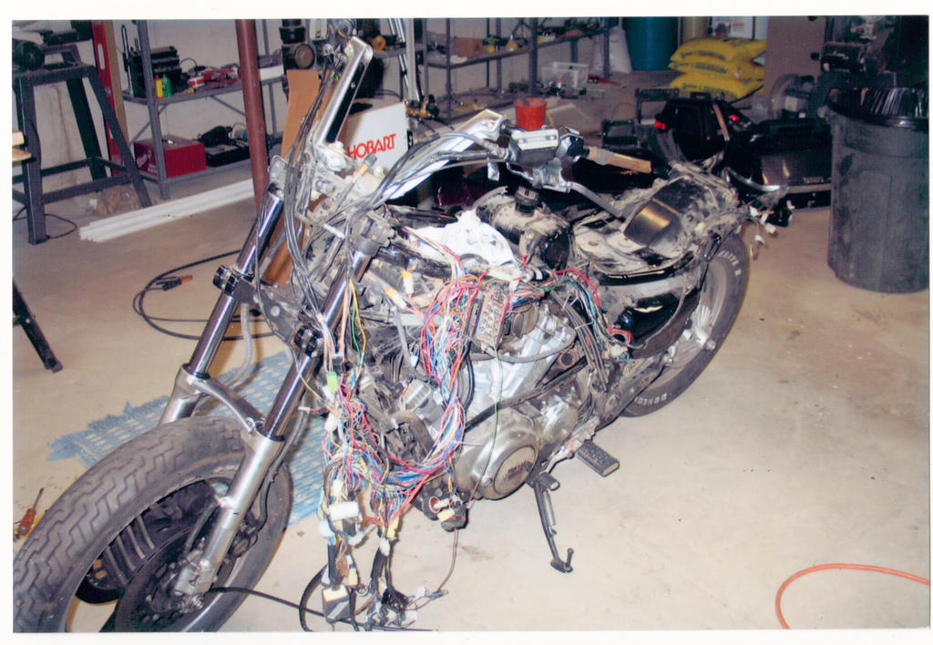

zagger Posted January 20, 2018 Posted January 20, 2018 (edited) It was electrical that where everything started this spring. I've been down every wire in that thing 3 *. Well, there are certainly a lot of wires. Here is a picture of my 83 with the wiring exposed. I removed all the stock wiring and put in new wires which fit my modified bike better. I would try to carefully inspect the routing of every wire in the areas where they worked on the bike. Of course, if you can figure out which wires connect to the fuse which is blowing, that would be the place to begin. Since you may have difficulty spotting the partial short without knowing which wires to look at, you might want to try identifying the wires which go to the fuse by connecting one lead of your ohmmeter to the fuse in question and touch the other ohmmeter lead to a standard pin (like for sewing) which you poke through each wire's insulation (to contact the copper conductor inside). Ain't gonna be easy, but eventually you should figure it out. I really doubt that any mechanic would take the time to do this. If you don't own an electrical meter that can measure ohms, this would be a good time to get one! Might want to see if you can get a meter that will beep when it makes electrical contact with the probe wires so you can keep your eyes on the wires that you are probing. This meter appears to have an audible beeper for locating electrical continuity: https://www.amazon.com/Etekcity-MSR-R500-Multimeters-Electronic-Multimeter/dp/B01N9QW620/ref=sr_1_6?ie=UTF8&qid=1516463438&sr=8-6&keywords=vom zag Edited January 20, 2018 by zagger

snyper316 Posted January 21, 2018 Posted January 21, 2018 Wouldn't one be able to take a multimeter and test it that way? and trace that wire. My bike pretty much have the TCI box wiring seperate from that speggattie mess that zagger shows, I just have 2 final wires to put in and it will be totally seperate, I like Venturous Randys suggestion of the straight 12.4 volts relay to TCI box, and I bet it would make big difference!!! I may order the wiring harness I seen online for parts and order me some wire and plugs and try to build my own with special attention to the Dash wiring so it has slack and quits tugging at the CMU. I seem to have winter here thanks to Saddlebum leaving the back door open. But today Tinker Got to stretch her legs as did I!! I rode all 3 of my bikes today it was 68 degrees outside. Seemed like swimming weather!! We aren't into February yet so sure there is more winter to come. May see what other project I can get into. Man I love SNOW But hate Winter, its not good for the body lol!!
