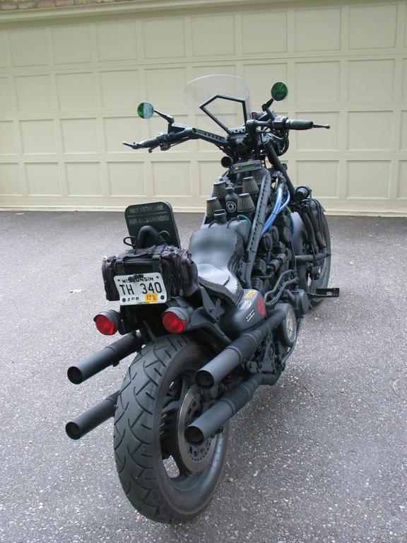

Spokane Dave Posted March 3, 2017 Share #1 Posted March 3, 2017 (edited) Hello. . . All I picked up this 84 XVZ12L for a song last fall, and due to the crappy plastics / heavy crap they pile on these bikes, as well as the new found desire to build a custom bike = I am now in the process of stripping it down and converting it to an AD-VENTURE Dual Sport machine or more commonly called Mad Max bike / Rat Bike / or perhaps may turn into some sort of Steam Punk look . . . Plan is to go to kind of a scambler style with as agressive of tread I can get, and I am going to paint the entire bike Flat Black. Shortly after I picked it up and cleaned it up, as nice as it looks - there were a LOT of cracks in the plastics at connecting pionts, so I decided it needed to become a naked bike The more you take off = The sexier this bike looks !!! Not to mention all the weight that is getting removed I have eliminated the big #$%^& air box and have gone with some simple air filters. Bike started and ran "fairly Well" I have since removed the carbs and thoroughly cleaned them out, but am going to do valves and a few other things before re-installing the carbs. If carbs end up needing total rebuild / Diaphragms etc. I am going to make a 4 into one intake and will be converting it to a 2 barrel carburetor. I have removed the funky air box on top of the front cylinder that the Exhaust ports vent to and will be plugging the ports in the engine with 1/4 /20 /3/4" Allen head bolts and a little RTV. The fuse block is absolutely shot, so I will be updating that with a new one with newer style blade fuses. I have been divulging through all the tech info on the sight, but have a few questions for you guru's 1. In removing the airbox I have eliminated a place for the engine case vent to insert into for re-circulation through the engine, any suggestions what I can do with the vent line = PCV Valve or ? 2. There is a small rubber hose coming from the cooling system where the fan / temp sensors are, and it goes down to the same cover between the Cylinders that the case vent comes from. What the Heck is that hose for from the cooling system? 3. Considering the bikes name = AD-Venture - I am hoping to find an aggressive tread pattern for the tires, but as we all know 16" are a rare commodity in the MC tire industry, so if anyone has any suggestions I would appreciate it. Clearly they need to be sufficiently weight rated and speed rated for at least a buck and a quarter (125mph) or preferably higher, as while I am getting old I am still a throttle junkie who loves triple digit riding when the rural open country environment allows it. 4. I am going to do the valves in the next couple days when I can find the spare time. I was wondering if there is any "custom Creations" people have made that work like the Yamaha tool for removing the valve shims without the need of unbolting the cams like I have to do on the Connie and KLR? 5. The Bike came with a complete set of MARKLAND Crash bars / Floorboards with highway Bars / floorboards as well. I am going to be removing the Markland system and reverting back to stock footpegs due to the type of riding I will be doing to allow for more sure footing / not so wide a stance. We have a salvage yard here, but they are still buried under a foot plus of snow, so it may be a few weeks before I can get in there and see if they have the stock pegs I need. Trying to nail down what goes with the Markland setup and what I need to get to get back to stock footpegs: I see on the left side where all I will need is the footpeg as the cradle is still there, and the back half of the shifter system will be removed as it is a part of the markland system, so as far as I can tell all I need is the left footpeg for the left side. Can anyone confirm that? Left Side: The right side however is a different story. There is a plate with peg mounted to it for braking that will be removed with the markland system - Does the right footpeg bracket and peg just bolt in where the plate and peg is in the picture? Right side: I looked around and could not find any of the vintage Markland sets for sale, as they where made in the 80's and no longer available from what I have derived. I am going to be selling the complete Markland after market Crash bar / floorboard setup, so any suggestions as to what a fair price is would be appreciated. They are not removed yet, but are in remarkable condition as you can see just a little dusty. They are pretty heavy I would imagine so shipping may not be to cheap ? If anyone is interested in the set let me know. Would be more economical to just pick them up personally if you happen to live in the beautiful Pacific North West. 6. I see the front forks have what appear to be anti fork dive system is this what this is ? I see where the back brake applies the rear and front left brakes, and the front applies the right front. I made an attempt to bleed these when bleeding the brake system with a vacuum bleeder but it did not appear to bring any fluid out? Am i Missing something? I am sure there will be more questions, but that's all I have for now. . . . and I thank any and all in advance for any info / or insight you can give me. Make it a GREAT DAY!!! Stay tuned and watch this crazy creation come to life ! Edited March 3, 2017 by Spokane Dave Link to comment Share on other sites More sharing options...

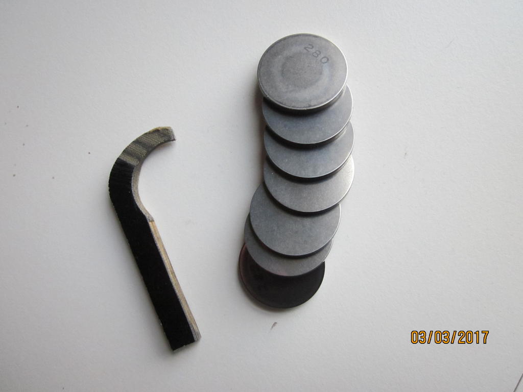

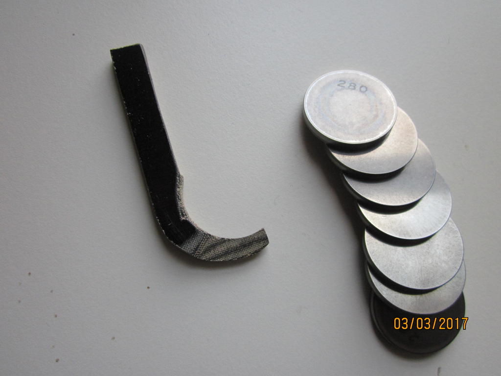

zagger Posted March 3, 2017 Share #5 Posted March 3, 2017 4. I am going to do the valves in the next couple days when I can find the spare time. I was wondering if there is any "custom Creations" people have made that work like the Yamaha tool for removing the valve shims without the need of unbolting the cams like I have to do on the Connie and KLR? Dave, Here is a picture of the tool (and some shims) I made using a small piece of phenolic (mine was fabric filled) but I imagine that you could use metal or something else. zag Link to comment Share on other sites More sharing options...

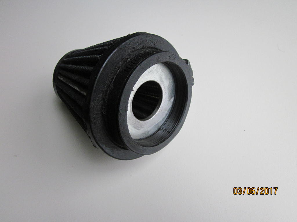

zagger Posted March 3, 2017 Share #8 Posted March 3, 2017 I have eliminated the big #$%^& air box and have gone with some simple air filters. Bike started and ran "fairly Well" Dave, If you compare the pressure drop of the stock air box and your replacement filters, I believe that you will discover that the new filters have a lower pressure drop than the stock setup. Problem is that the carbs are designed to work with the stock filter box not your new filters. Perhaps this difference can be handled with some internal carb changes - or maybe not. Years ago, when I did my mods, it didn't seem like there were carb modifications available to handle the inlet filter pressure changes. I fixed the situation by putting airflow restrictors (basically large washers with a machined ID) inside each filter. I did quite a few airflow pressure drop calculations in an effort to figure out what was needed. Here is a picture which shows my intake filters. The bottle in between the intakes is the crankcase "schmutz" collector which traps junk from the crankcase (I probably should mention that I also have a filtered fresh air inlet to supply fresh air into the crankcase). zag Link to comment Share on other sites More sharing options...

Flyinfool Posted March 4, 2017 Share #11 Posted March 4, 2017 Sounds like fun. As mentioned, anytime you mess with the air filter or air box the carbs do not like it. You will have to either rejet or do like Zagger and restrict air or maybe a combination of both. I also made my own Valve tool, I originally copied the Yamaha tool, but that was very hard to machine. So I redesigned it to work the same but was a lot easier to make. Link to comment Share on other sites More sharing options...

snyper316 Posted March 6, 2017 Share #21 Posted March 6, 2017 Hey Dave, I checked my notes and calculations from years ago and decided I better pull off a filter just to be sure that I didn't give you bad information. The washer ID is 1" and each carb has its own filter. My filters are K&N and look like this one: http://www.knfilters.com/search/product.aspx?prod=RU-2580 I'm not sure of the K&N part number, but you would need to use one that fits your intake anyway. These filters are cleanable and need to be sprayed with a special K&N filter oil after cleaning. zag http://www.venturerider.org/forum/attachment.php?attachmentid=108586 Just to pick on ya, looks like the other 3 need to be pulled and cleaned; Link to comment Share on other sites More sharing options...
zagger Posted March 6, 2017 Share #22 Posted March 6, 2017 Just to pick on ya, looks like the other 3 need to be pulled and cleaned; It only looks dirty due to the lighting in the picture. These filters can hold quite a bit of crud and none of them are due for a cleaning anytime soon. Of course, since they sit out in the air right in front of the rider, it is easy to notice when they are due. I spray them with some cleaner stuff and the dirt easily rinses off. I blow them off with compressed air and let dry before reapplying the filter oil. Lot's better than just tossing them all in the trash! zag Link to comment Share on other sites More sharing options...
