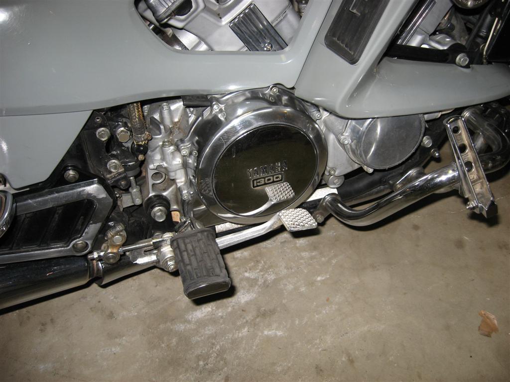

GaryZ Posted March 7, 2017 Share #31 Posted March 7, 2017 "The right side however is a different story. There is a plate with peg mounted to it for braking that will be removed with the markland system - Does the right footpeg bracket and peg just bolt in where the plate and peg is in the picture?" My '85 had floorboards and I discovered that my they cramped my ankles after a bit. I replaced the front floorboards with these adjustable driver footpegs found on ebay: Link to comment Share on other sites More sharing options...

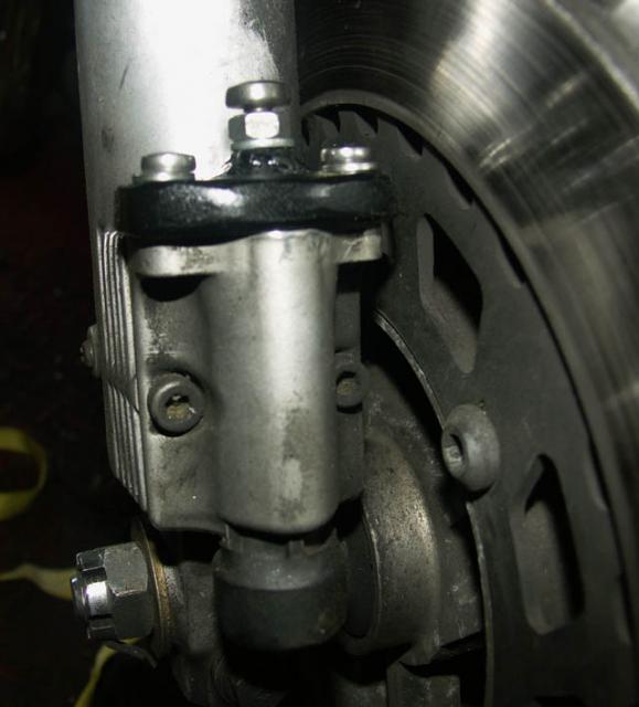

GaryZ Posted March 7, 2017 Share #32 Posted March 7, 2017 (edited) "6. I see the front forks have what appear to be anti fork dive system is this what this is ? I see where the back brake applies the rear and front left brakes, and the front applies the right front. I made an attempt to bleed these when bleeding the brake system with a vacuum bleeder but it did not appear to bring any fluid out? Am i Missing something?" My '85 has Progressive fork springs. I have de-linked my brakes and disconnected the anti-dive devices by simply removing the hoses. I have also reduced the weight of my '85, probably not as much as you will be doing to yours. Unlike many others here, I think the stock, de-linked brakes on my Gen1 Mk1 work fine. This conclusion is based on comparing my modified '85 VR to my '99 ZX11D Ninja. There is a thread somewhere that talks about fabricating a plate for the top of the anti-dive device that will allow you to adjust damping. Edited March 7, 2017 by GaryZ Link to comment Share on other sites More sharing options...
Spokane Dave Posted March 8, 2017 Author Share #33 Posted March 8, 2017 Well been snowing to beat hell hear all day so figured it was a good time to get to the valves. Every stickin one is tight, so glad I checked them Now. . . I either need to make, buy or borrow a valve shim removal tool - hate to buy it to use once so If I cant find one from a local buddy I might have to make one. Here are the measurements from the valves if anyone is interested I did find removing the needed feeler gauges from the pack and adding a slight bend did help in checking them properly I did remove the floorboards and forward crash bars / highway pegs, and will be selling them as a set along with the heel shifter and rear brake footpeg. Bike looks much better, and lighter with them off Left peg bracket is there just waiting for me to make some custom pegs However, as mentioned prior - there is NO bracket for the right side to even mount a peg to what so ever, so I think I need the stock mount only minus the peg:think: Hey Gary - can ya post a pic of the right side footpeg "bracket" - is it stock ? I think I will wait to ride test the combo brake system and see how it is, but most likely will be separating the front from rear as I am a big fan of skid steering This looks interesting and I will have to look into the mod more when the time comes as the anti dive sounds like a good feature Especially where I plan on AD-Venturing to Link to comment Share on other sites More sharing options...
Pegasus1300 Posted March 9, 2017 Share #34 Posted March 9, 2017 Curious as to why to remove the anti dive system? Is it faulty or ? I probably have the parts laying around to separate the front / rear brake system If you look a the picture - the rear portion you see on the shifter does in fact come off and goes with the Markland set. Been looking at pics online but not that familiar with this bike in particular so lacking in confidence as to what is needed to get the pegs back to stock well yes it is faulty and if you put Progressive Springs in the forks you won't n ed them anyway. Removing the anti dives and delinking the brakes makes them ever so much easier to bleed and the work a whole lot better. Besides with anti dives gone and the brakes delinked you can add R6 calipers and have a real stopper. BTW sorry to take so long to answer you I haven't been here for a couple of days. Link to comment Share on other sites More sharing options...
