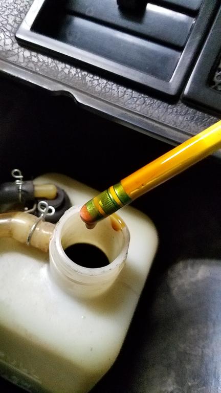

videoarizona Posted November 23, 2016 Share #1 Posted November 23, 2016 Yeppers. Some problems showed up. 1: The coolant overflow/reserve bottle top broke. No kidding, the top split in two. Top half and bottom half. Got some glue on it now but found that to be interesting that it would break. Not sure if the glue will hold so will start looking for a replacement soon. 2: The coolant level looked good in the bottle. Then I looked a bit harder. Hmm. Grabbed a pencil and stuck it in the bottle.....the end of the pencil came out with a coating of "stuff". Looked like motor oil and consistency of honey! What the...? I haven't had time to look and see what the heck is going on, but seems to be the coolant bottle is isolated from the rest of the system as the coolant itself is a nice green color. And the scoot doesn't overheat....even in Arizona's summer. Guess I'll try to find some time this weekend to look and see if the hose is plugged...which is my first guess. Anyone ever run into this problem? No pics. I'm to tired after a nice weekend sailing the lake. We anchored out in a cove...six little yachts. Pic of boat is my Scotch Mist, 23ft Aquarius. Link to comment Share on other sites More sharing options...
M61A1MECH Posted November 23, 2016 Share #2 Posted November 23, 2016 (edited) That is the classic symptom of the water pump seals gone bad. There is a driven shaft that comes from the motor thru an oil seal and a coolant seal that drives the water pump, they have been known to go bad and let oil get pushed into the oil. Because the oil will float on the coolant it tends to gather in the top of the radiator where it will find its way to the over flow drain and into the coolant recovery bottle, where it floats on top of the coolant. Edited November 23, 2016 by M61A1MECH Added some additional information Link to comment Share on other sites More sharing options...

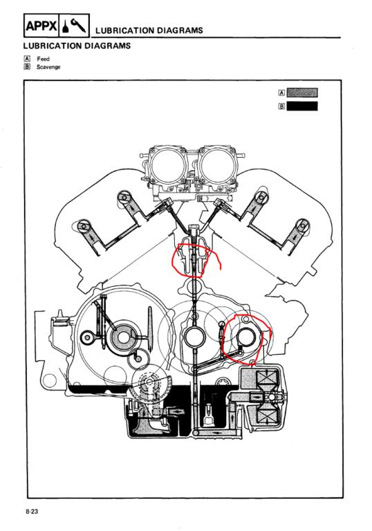

yamagrl Posted November 24, 2016 Share #12 Posted November 24, 2016 Below is a screenshot of the Lubrication Diagram Pg 8-23 in the 86-93 manual. It appears that the only common areas of coolant and oil is the Water Pump and the Twinkie. It doesn't look as though oil passes through the head gasket but coolant does. That means that if the head gasket were faulty then the sludge would be a due to air/fuel as well as combustion by-product mixing with coolant. You might get an idea by running the engine with the radiator cap off. I think exhaust gas, etc. would bubble out. I have an 89 with the same issue. I haven't had the time to figure it out yet. I have my fingers crossed for the water pump or the twinkie. Link to comment Share on other sites More sharing options...

videoarizona Posted November 29, 2016 Author Share #20 Posted November 29, 2016 (edited) Latest: Finally decided to get down and dirty. Picture of "stuff". The seep hole in the bottom of the water pump is dry. Took off radiator cap and nice green coolant came out...no oil. No coolant in oil either. So...I can only conclude that the seals in the water pump did go south at one point as there is evidence the PO used a sealant of some type on cover and there are old stains on aluminum around bottom of pump. This junk may be left over from previous problem (not flushed out) and finally collected at top of coolant bottle. My plan now is to clean out the bottle and fill with coolant to proper level and run it like I stole it. In a month or so...re-check the coolant bottle and see what's there. It has never overheated in the Arizona sun....even while idling in summer heat The fan is obviously doing it's job as well. BTW, the radiator cap is an original I think and does not have any "stops" when tightening it. It simply tightens and stops. Never leaked yet. As a side note... the bike has been down on right side as there is a tiny crease of the infamous water pump pipe next to the crash bar. Will take off the crash bar and grind down the area that can cause problems if I lose it on right side. That crease was hard to see but it's there. NOW....how the heck does the coolant bottle come off????? :think: Edited November 29, 2016 by videoarizona clarification Link to comment Share on other sites More sharing options...
