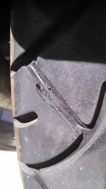

bongobobny Posted August 13, 2016 Posted August 13, 2016 There are a lot of us here on the site that will not run Metzlers even on a dare!! Several years there was a LOT of them literally throwing off chunks of rubber off and in a few instances resulting in crashes!! The Avon Venoms were for many years one of the "go to" tires but a few years ago some people started having issues with them as well. As far as tread wear numbers go, the Dunlop E-3 had the highest, higher than the Michelin. I believe that is also the case with the new E-4's. Don't even think of Dunlop D404's, they do not wear worth beans on the Venture even though they are rated as a "Touring Bike" tire. Maybe fine for lighter ones, but not on the almost 900 lb Venture. You are going to get many varied opinions on this thread, and it all depends on driving style, your pocket book, and how much you ride in the rain...

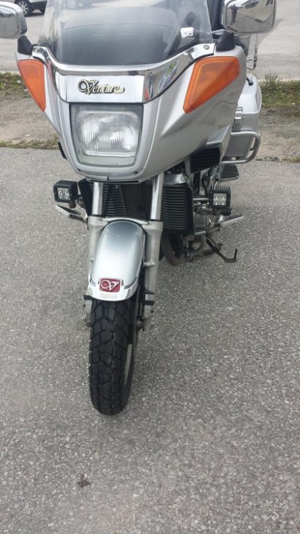

cowpuc Posted August 13, 2016 Posted August 13, 2016 Hey Casey - just finished reading your other thread about your new scoot - WOW ZZZZZ WOW WOW WOW - she is a DANDY = CONGRATS!! Bongo mentioned spying some add on's in that thread - I think I saw more = gotta go back sometime and add to his list .. Don mentioned somewhere about tires being the cause of the hummmm you are experiencing when your scoot is anything but straight up = now reading that you are running Metz's - I can attest to having experienced the noise your are talking about and affirm that Metz's were probably the most pronounced for that noise = my money is on new tires will alleviate the noise.. I am one who had a Metz fail. Long story short, the tire delaminated while out in California - see pic. Have tried many brands over the years, always maintain proper air pressures but do require a lot out of my tires = we load heavy, ride desert temps but ALWAYS purchase higher load level tires (74H or higher).. Michillin has been the highest mileage tire = 6500 miles. Dunny 404 the lowest = just under 4000 miles. I carry spoons and swap my own tires so, IMHO, the 180 bucks I paid for the Mich was no where near worth the cost when considering I could have almost purchased 3 other lower end tires for that price. A good example of this is that I replaced the Metz in the pic with a 65 dollar (shipped) "Full Bore" M-66 - that cheapy Full Bore did an AWESOME job and lasted 5000 miles in 110 degree desert riding fun.. I have read and reread many many writings about folks getting really high mileage out of their rear tires - unfortunately I am not one of them. I do personally know people who have ridden on "dual compound" Dunlop tires and know for a fact that my buddy has just under 15000 miles on his and it is ready for a swap out. Last time I checked - that Dunlop he is running on his Ultra Limited was $245. Again,, IMHO - 15k for 245 bucks does not = 5k for 65 bucks BUT - again,, I dont mind swapping my own tires.. Here is Tire Poll you might be interested in: http://www.venturerider.org/forum/showthread.php?118014-POLL-2-for-REAL-this-time!!!-What-kind-of-mileage-do-you-get-from-a-rear-tire&highlight=tire+poll and here is where you can find pics of the Metz problem with had - if this link does not take you right to the proper page - you can pass thru all the nonsense in the ride article and go to page 15 and post 223 at this link to read all about it: http://www.venturerider.org/forum/showthread.php?94309-Ahhhh-the-summer-of-14-ADVENTURE-SERVED-UP-GORMET-STYLE!!!!/page15&highlight=metzler+tire I tried unsuccessfully (we have line problems here in my area) to post pics - sorry but you will have to follow the above link if you want to see them.. By the way,, I am still thinking that its the style of Tread that makes the Metz sing and viborate some when cornering - especially after they have worn the radius off in the center of the tire a little.. Hope this all helps - CONGRATS on the new scoot = IMHO, you did GREAT Casey!! Puc

snyper316 Posted August 14, 2016 Posted August 14, 2016 After looking at @cowpuc post realizing my tire is identical to the one he has in a picture made me look at mine and I have Metzler's on front and back of my bike and getting down on the ground taken closer look after spotting the name to think the night I got my bike running again long story short I was in triple digits with a crack running all around my tire on the rear and the front is starting to develope and finding out last night more on date codes that my tires are going on 8 yrs old well um yeh I'm in market for tires but I'm funny when it comes to tires I will not buy the cheapest but rather go with known good brand... So I guess I will do a vote on ppl experience with different brands and the ones with the most recommended I will run with Sent from my Z812 using Tapatalk

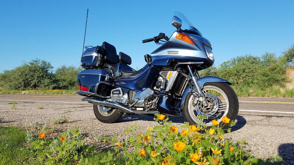

videoarizona Posted August 14, 2016 Posted August 14, 2016 Shinko is a good tire. I'm running the Tourmasters on my 89...the original tire size! Don't get a narrower tire for a 1st Gen...only need that for the 2nd Gen. I'm very pleased with the ride,etc.. E3's are about the best for a high end tire. Good ride, traction and durability. I think Shinko is best for a cheaper brand...although that really is a misnomer. They bought Yokohama....and are making their tires better than they did! The only negative seems to be wear on the rear...mine have been on for over a year and no appreciable wear so far...about 4K miles. But that doesn't bother me. Like Cowpuc...I don't mind changing out the rear....it's a good maintenance time. 1st pic is of my Metzler failure. The tire split open and had a nice bulge going as I zinged down the highway at 75. Felt a thumpity thumpity start and get worse. Saw the bulge as the tire was splitting. Went home very slowly on back roads... 2nd picture was taken this morning....you can see the rear and front still look great...

videoarizona Posted August 14, 2016 Posted August 14, 2016 Wass up Vaz? Hey,, was reading on a recent post about Fork Braces - noticed someone had something on there about having to wire up the bottom of his fork gators when he put on the new brace - remembering our discussion about the brace you got from Riv and now gotta ask,, is that GORGEOUS 89 yours one of those models that was suppose to have gators on it? Maybe those lower leg tops are a little bigger cause of it? Sorry for the Casey - another flaw in my character Morning Puc, I don't believe my 89 had gators when new....I think that was from 90 on. Maybe I have a late model fork designed for gators that got on my scoot during manufacture...don't know. RIV sent me his other brace...but haven't had the time to try it out. If it doesn't fit...then I do have something going on with forks. I "know" I put the front end back together properly as I laid everything out as I went along?!?! She sure rides well though... But we shall see.....
