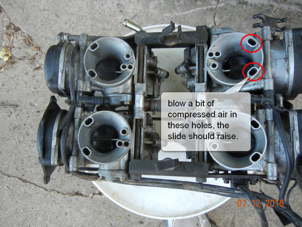

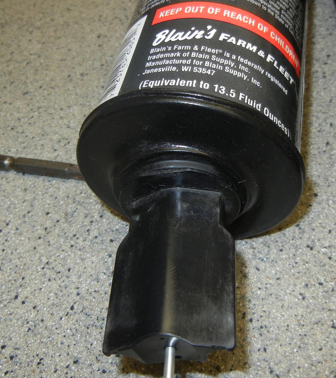

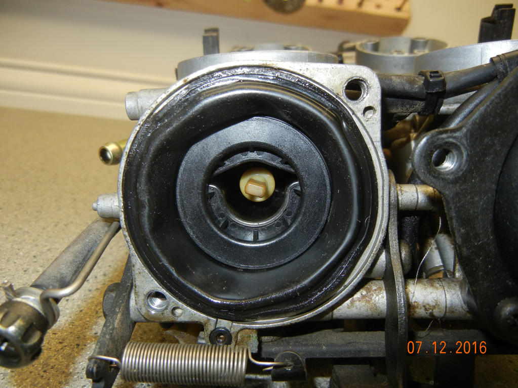

gggGary Posted August 4, 2016 Posted August 4, 2016 do this before taking the carbs out. on this set one one diaphragm didn't rise, found this. then did this so it was easy to reinstall diaphragm in the groove. Now the bike is in the groove also. Bike did run "just fine" on 3. But it runs better than fine on all 4. I went in because fuel was leaking out of a couple of carbs. Full disclosure; I just got the "correct" set of float bowl o-rings (hint the K&L parts DO NOT FIT the ventures.) The right ones; [TABLE=width: 100%] [TR] [TD=width: 60%][TABLE=width: 100%] [TR] [TD]4XV-14562-00-00 O-RING (Yamaha Motor) $6.17[/TD] [/TR] [TR] [TD]In Stock[/TD] [/TR] [/TABLE] [/TD] [TD=width: 10%, align: right]4[/TD] [TD=width: 10%, align: right] [/TD] [TD=width: 20%, align: right]$24.68 [/TD] [/TR] [/TABLE] and will install them and do idle and synch this week. Also note that there are 3 different main jets used it's kind of important to keep them in the right carbs..........
Rob Swallows Posted August 4, 2016 Author Posted August 4, 2016 Thanks Gary; I did perform that operation with both the new, and former diaphragms and all worked well. Citing they were 11 years old I elected to replace rather than trust rubber sealing once it's mounting surfaces had been disturbed. The bike seems to run very well but I've not ridden it since carbs are reinstalled. I had heard about the K&L kits being questionable so went with genuine Yamaha parts and had no problems at all. I set all the float levels "spot on" in relation to each other as closely as humanly possible. I've not adjusted the mixture screws yet either but did count the turns upon disassembly and reassembled the same. All jets were oriented as removed and no mix ups. I replaced no hard parts, only rubber and sealing rings. Some of the jets were in fact plugged from the wonderful fuel quality we must endure, but it removed in the solvent bath. I'll get it optimized over the weekend if it doesn't get into my "grand daughter" time cause there isn't anything in this world more important than that. Thanks, Rob

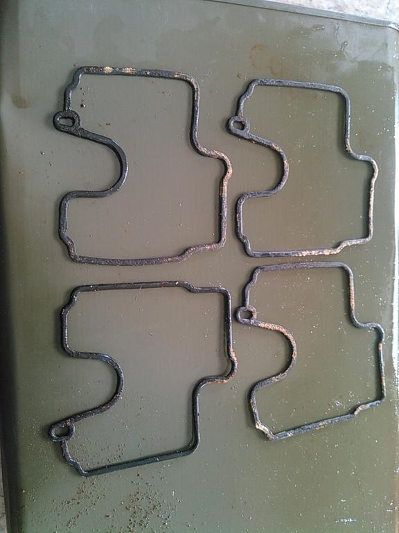

Rob Swallows Posted August 16, 2016 Author Posted August 16, 2016 Forgot to post this which are the original float bowl gaskets from my Venture. I didn't photograph the insides of the carbs but they were worse than these show. All good now with OEM parts replacements and thorough cleaning. Cylinder #1 , and #4 seals are on the right which were the two misfiring at higher speeds. The idle was perfect. Although I've not ridden the bike since repairing it, it's probably going to be better than it was.
