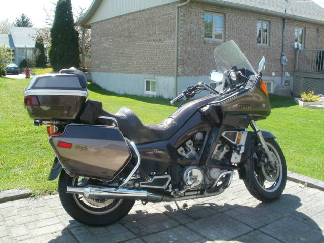

jfman Posted July 4, 2015 Posted July 4, 2015 Hey guyz, I just bought a running 1983 (or is it an 1985?) Yamaha venture for a song and I would like to work out a few bugs on it before going on a longer road trip. This bike has a special fate but the details are still brewing. This model has the air suspension on it that I cant seem to be able to get to work. The suspension is quite mushy and I would like to stiffen it up a bunch if I can and also raise it if possible. Is there hope for the air compressor system? Is it a costly and complex? Is it better to remove it in some cases? I am also wanting to replace the fork oil for a thicker substance. Open to any insight an suggestions but keep in mind I am not wanting to spend much money on this bike. Anyway here is a picture of my bike.
Yammer Dan Posted July 4, 2015 Posted July 4, 2015 1985 The Air system will only work when switch is in Acc position. Don't overair the Front!! Can get costly. Start with about 7 lbs in it. Don't overair it!!!! Around 35 in the rear. Spend the 12 bucks on this site and wonder how you ever got along without it!! Looks like you may have stolen a great bike.
Venturous Randy Posted July 4, 2015 Posted July 4, 2015 Yeah, that is an 85 and what is the last four of the serial number. Hope it is above 1413 and that will resolve the 2nd gear issue. There is a lot on here about a resolder on the CLASS controller and that usually fixes it. Welcome to the forum and hope you join. Like yammer said, it will be the best $12 you will ever spend on your bike and we come along for free. Randy

Flyinfool Posted July 4, 2015 Posted July 4, 2015 As mentioned above, the air suspension system does suffer from bad factory solder joints, quick and easy fix. Getting the CLASS working will stiffen up the suspension a lot and also raise it a bunch. The bike was designed to have air in the suspension at all times. It is also common for the front springs to be worn out, a new set of progressives will fix that, it is almost by default that the spring change will get new fork oil. Not only is that bike running, and complete, but looks clean to. A real steal.

bongobobny Posted July 4, 2015 Posted July 4, 2015 Do a search and find a lot more info on the CLASS system! For the front I would buy a new set of progressive springs and be done with it!! You won't need heavier oil or air in the front shocks. Clean out the tubes and put new oil in there when you replace the springs. $250CAD?!!? Heck you can sell the upper fairings stripped and still make a profit!!! You STOLE that bike friend, add a zero and that's what one in good shape is worth...
jfman Posted July 4, 2015 Author Posted July 4, 2015 (edited) Hello guyz: I just paid the 12$ so my cost for this bike is 250 CAD + 12$ US so far. To be fair I need to post up more details. Yes the bike was only 250$ CAD but it does have the 2nd gear problem. The man who sold it to me told me the 2nd gear has been messed up up for over 5 years but he kept riding it like that anyway. I do not want to fix the 2nd gear. I just want to put good rubber on it and fix a few quirks that are making it unsafe right now. Now I hope this next part wont anger too many members on this site. I bought this bike with the sole intention to ride it to a destination, abandon/sell/donate it and fly home. On my other bike I have ridden to Alaska and Mexico. If you are interested, you can read my ride reports here: Alaska 2014: Hotel Budget Zero Spending Christmas in Death Valley and the New Year in Urique, Mexico Tour of the American West 2013 : Anyway I plan to ride to either Anchorage or Cancun or mayyybe around the US to San Diego (still unsure) and fly home. For this reason I dont want to sink too much money into it. I just hope the bike will survive the trip is all. Knowing full well it may not but that is part of the appeal of this trip. For now I need to fix a few quirks on this bike to make it safe to ride then it will be ready. I have always wanted to do a bike abandon tour and I think this bike will fit the bill. I cant wait to go on a great adventure with my Venture Edited July 4, 2015 by jfman
