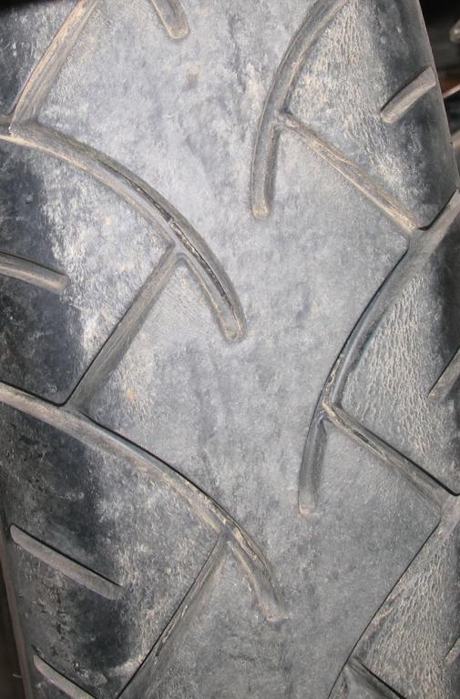

k9cottage Posted June 28, 2015 Posted June 28, 2015 speaking of metzler i have just had some fun and will never get another. this is a story i put into our ULYSSES magazine warning others about metzler and there tyres . the cracks run right around the tyre NOT A HAPPY CAMPER After our round trip with cub camper behind our Royal Star Venture + sidecar to Alice 7500ks I decided the trusty Avon Venom rear tyre was looking a bit sad. Yes i could get another 1000 to 1500ks left in it, but the Wodonga trip was to be about 3000ks [no pillion this time and no cub camper but did have a very small bike trailer 4’x4’ containing tent and some water and food. Start time was getting close so went online to Evilbay looking for a good cheap replacement rear tyre. I found Motorcycle Tyre Warehouse had a METZELER ME880 MARATHON at a good price delivered. It showed 3 days later, good looking tread and meaty, just what I need for my outfit. I then ripped the old Avon off and fitted the new tyre, left the bike in the shed and didn’t get it out till it was time to go to the boat for the trip to Melbourne. After getting off the boat and heading for Wodonga the bike was just not right so we continued on to Wodonga at a steady speed in no hurry. We cruised up the Hume at about 90kph. We got to Wodonga about 2:30 Tuesday 24th. Wednesday morning we started looking for the problem with the bike. New plugs fixed the slight miss in the motor but still had a grinding noise at takeoff. We decided it must be a crook universal so we spent the rest of the week sitting around the campsite not wanting to put too much pressure on the uni. It was decided then not to do the long trip home via the coast but have a slow trip back down the Hume to Broadford for the Easter bike bonanza [what a great weekend ]. The grinding noise was found to be not a crook uni but a broken stay on the sidecar grinding when the sidecar wheel moved so returned home all running well and normal .Then the fun began in the shed. I checked the rear tyre to find deep cracks in the base of the tread [the tread was lifting off the case] so i sent an email to motorcycle tyre warehouse with photos [no reply]. A few days later I sent another [still no reply].A couple of days later I phoned [oh yes we got your email can you send more pics] so sent more close-ups. A week later I sent another email asking what is happening. Then got an email can I phone them. They asked me was I towing a trailer, said yes, to be told Metzeler do not cover any warranty for a bike towing a trailer. I said the trailer puts 15kgs extra weight on the bike they don’t care they found a way out for a badly made bike tyre. I have since sent an email to Metzeler but still no reply. I would have been better off leaving the old avon on the bike .By my GPS I covered 1142ks with a top speed of 115 kph turned out not to be a cheap tyre so if you are thinking about a new tyre and want to tow a trailer DO NOT buy a Metzeler 1
Yammer Dan Posted June 28, 2015 Posted June 28, 2015 Speaking of.....I had just changed to a Metzeler before my MD trip. I don't think that thing would have locked up that easy with the Avon I had just removed. Still not sure what put me down.
