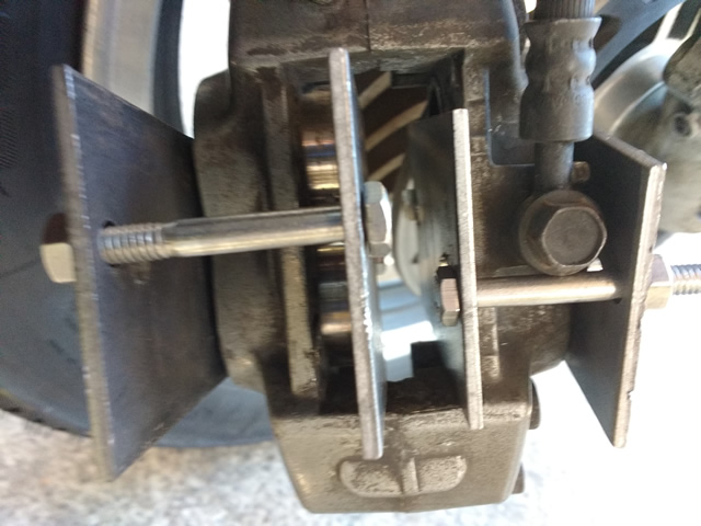

camos Posted August 14, 2016 Author Share #41 Posted August 14, 2016 I have never disassembled a caliper but I know a number of you have. How long are the pistons or how far out can the pistons be moved before they are in danger of popping out? Link to comment Share on other sites More sharing options...
cowpuc Posted August 14, 2016 Share #42 Posted August 14, 2016 Only had to pop pistons a couple times to get a good caliper together, run pistons out to the width of a new brake pad (always figured 1/2 a backing plate width beyond the width of pad was a good place to stop the piston - never have had one pop out using the new pad as a gauge) - rip a piece of old cotton tea shirt to kind of match the width of the exposed piston and 8 or 10 inches long - slip it around the piston and pinch the two ends together so I have the exposed piston wrapped nice and tight in the good clean rag - soak it up with carb or brake cleaner - move the rag back and forth around the piston - remove the rag and examine piston to see if streaks are cleaning up - make another wrap and clean until the pistons a sparkly clean - last cleaning I use a clean rag with brake fluid on it - push the piston back in - push it back out and check for more rub marks - if rub marks are present I start over - when completed I do the other side.. 99% of time this cures sticky calipers. Link to comment Share on other sites More sharing options...
bongobobny Posted August 14, 2016 Share #43 Posted August 14, 2016 They're about an inch deep camos. what I usually do to disassemble is use various thickness of wood in between the pistons and compressed air applied to the hydraulic input to the caliper. Actually what I do is a piece of 1/4" plywood between the brake pads, then remove the wood and hit it again with air, then remove the pads or at least one pad and insert the plywood if needed. Once one piston pops that's as far as you can get with air, then the rest of the pistons have to be carefully removed. You might want to try the Pucster tee shirt trick to see if that fixes it for you, good idea! Are you doing the front or rear?? If you are doing the whole nine yards i.e. honing the cylinders, etc the front calipers are two piece. If that is what your game plan is, then for what the seal kits cost for the MK2 you may be better served considering a pair of R1 or R6 calipers instead... Link to comment Share on other sites More sharing options...
camos Posted August 15, 2016 Author Share #44 Posted August 15, 2016 @ Bob and Puc: Thanks for the feedback, it looks like about 1/2" out is safe for the pistons. Yesterday I made up a clamp tool which works quite well. It is 2"x4"x1/8" flatbar with 1/4"x2" bolts. Perhaps 3/16" might have been a better choice. Cleaned the pistons and went for a ride this morning. They are still sticking so will try again today. Link to comment Share on other sites More sharing options...
Condor Posted August 15, 2016 Share #45 Posted August 15, 2016 I just don't understand why the pistons aren't removed one at a time with compressed air?? All it takes is two pieces of ply wood. One the width and half the thickness of the opening between the pads, and the other half the width and one quarter the thickness... Glue them together and by rotating or reversing the set up one piston at a time can be removed by compressed air blown into the banjo bolts hole. Just be careful when using the air. They come out at a speed that would make NASA proud.... As far as cleaning the pistons I use 0000 steel wool to get the junk off and clean the caliper walls. Slip a new seal on the piston and reinstall and move on to the next. Only use DOT 3 or 4 to clean and lube. My 2¢ Link to comment Share on other sites More sharing options...
bongobobny Posted August 15, 2016 Share #46 Posted August 15, 2016 Ok, Clive, NICE SETUP!! Jack, never teried that method but sounds like it works good! I've never been that lucky to get all 4 to pop off together. Maybe two, but once one pops out all the compressed air takes the path of least resistance! Usually though, when one pops the other three are almost ready to come out and I can get them out by hand, or by taking a pair of needlenose pliers INSIDE the round part of the piston and while holding them open, pull them out the rest of the way. I clean pistons with solvent then buff them out with my metal polishing wheel. Depends on what shape the cylinders are in as to whether I just hit 'em up with very fine emery paper or get out the hone... Link to comment Share on other sites More sharing options...
Condor Posted August 15, 2016 Share #47 Posted August 15, 2016 It actually works very well Bob. I think I made a mistake... imagine that!.... in the decription in that the thick part needs to be half the size of the opening. The thin ply needs to span all the way across. That way three pistons are blocked and only one has the space to let the piston come out... Besides it's fun blasting them out of there... :-) Link to comment Share on other sites More sharing options...
