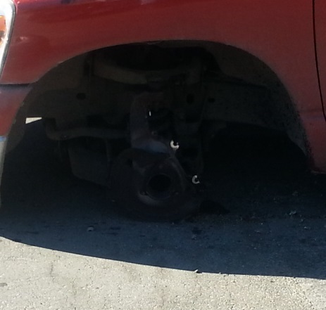

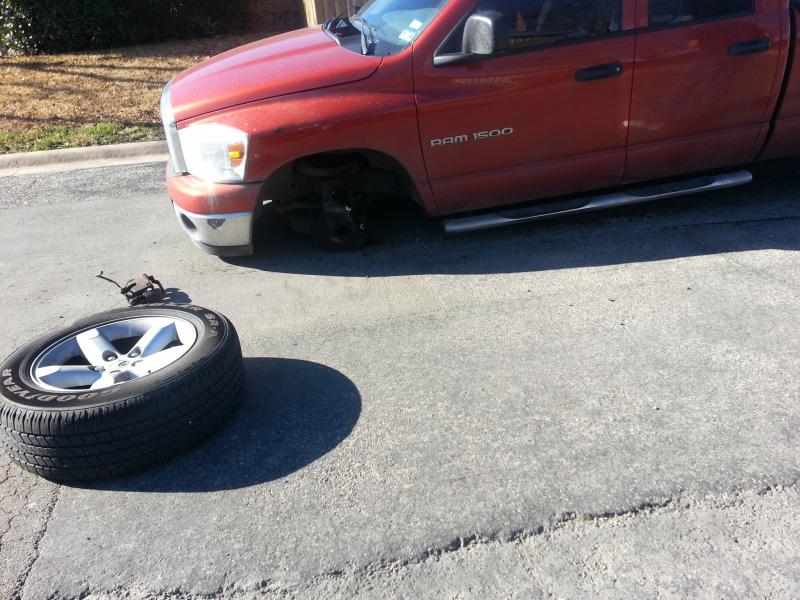

Du-Rron Posted March 19, 2015 Posted March 19, 2015 Check the Unit Bearings on the wheels so this does not happen to you.
slowrollwv Posted March 19, 2015 Posted March 19, 2015 LOL I had that happen to me at 70 MPH in a Ford Explorer. Had a four wheel alignment the day before and felt a vibration, tried to call the shop but he left for the day so I was going to take it back after work but it flew apart on my way to work at 5 AM. The guy that did the work left the axel not loose.
Du-Rron Posted March 19, 2015 Posted March 19, 2015 LOL I had that happen to me at 70 MPH in a Ford Explorer. Had a four wheel alignment the day before and felt a vibration, tried to call the shop but he left for the day so I was going to take it back after work but it flew apart on my way to work at 5 AM. The guy that did the work left the axel not loose. On this one the Unit Bearing gave out. The Unit Bearing, which contains the backing plate, brake rotor, and wheel sensor are still bolted to the wheel. Just no longer on the truck.
