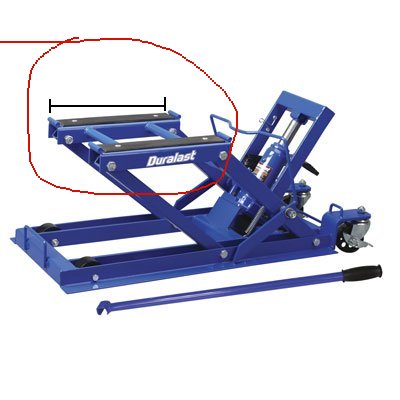

pbjman Posted December 1, 2014 Author Posted December 1, 2014 I would double check on the length of the saddle. If you are using Larry's lift adapter you need to make sure you've got the "stopper" with it and that the saddle on the lift are at least as long as the width of the lift adapter frame. My preference would be a lift with saddles longer than the width of the lift adapter and to not have to use the stopper. That way I know the adapter is sitting on pad and not hoping that I got the lift under the bike far enough. I have the Canadian Tire lift and I have to be careful that the end of the saddles are all they way against the stopper. If you don't have it far enough or are on an angle, you could drop your bike. Do you know what the length of the bars on the jack should be at a minimum. I measured under my bike and the frame is approx 12" wide from outside to outside. (give or take a little, it was a quick measurement laying on the floor squeezing in between stuff to measure.)
rougeray Posted December 1, 2014 Posted December 1, 2014 Carbon One's lift adapter is 12.5" The length of the saddle on the Sears jack is 13.375. That gives you .4375 or 7/16" on either side. I have never had a problem lifting my RSV with it. Go to his web site and I believe he tells you which jacks are marginal. BTW get the legs with it that way you don't take the chance of knocking the bike off plus the jack is out of the out of they way. First time you lift it the pucker factor goes way up......gets better the more times you use it.
pbjman Posted December 2, 2014 Author Posted December 2, 2014 Carbon One's lift adapter is 12.5" The length of the saddle on the Sears jack is 13.375. That gives you .4375 or 7/16" on either side. I have never had a problem lifting my RSV with it. Go to his web site and I believe he tells you which jacks are marginal. BTW get the legs with it that way you don't take the chance of knocking the bike off plus the jack is out of the out of they way. First time you lift it the pucker factor goes way up......gets better the more times you use it. If carbon one's adapter is 12.5 then I think I may pass on the Duralast. See those little nubs at the ends of the lifting skids? Won't those interfere with the adapter if they are not at least 12.5" apart?
Bert2006 Posted December 2, 2014 Posted December 2, 2014 I use it and have the lift adapter. No problems. Use the nubs as a stopper to ensure positioning on the lift.

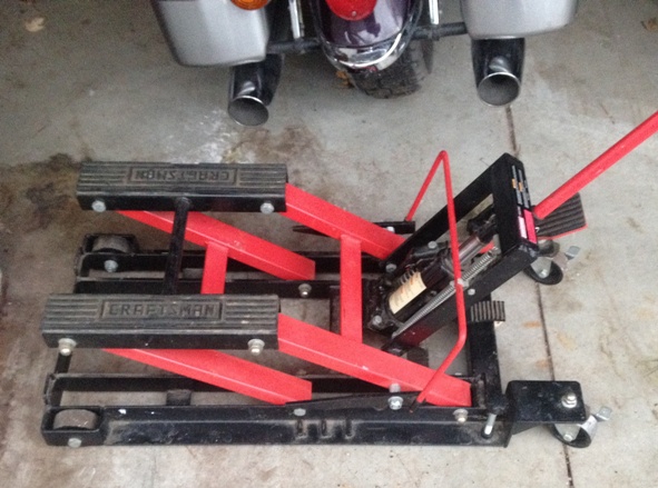

djh3 Posted December 2, 2014 Posted December 2, 2014 This is the one I have. Its from Sears, but I certainly did not pay $200 for it. I think closer to $125. I like that the front wheels are out side the frame and give a bit more stability in my mind.

pbjman Posted December 2, 2014 Author Posted December 2, 2014 Sorry, bike is stored for the winter. If i can find a picture I will certainly post. In the meantime, if you google search rsv lift adapter, a number of links come up with pictures. Yeah, I have seen pics of the adapter on some lifts, but I should have asked you to clarify if you have the exact lift in question, the Duralast from Autozone. I think it looks different from the HF / Sears ones because they have flat saddles/skids plus other differences in the frame and how the wheels mount. Are you saying that the adapter Larry makes at 12.5" wide fits between the nubs on the Duralast? Otherwise it would sit on the tops of the nubs instead of on the saddle, right?
Bert2006 Posted December 2, 2014 Posted December 2, 2014 (edited) Yeah, I have seen pics of the adapter on some lifts, but I should have asked you to clarify if you have the exact lift in question, the Duralast from Autozone. I think it looks different from the HF / Sears ones because they have flat saddles/skids plus other differences in the frame and how the wheels mount. Are you saying that the adapter Larry makes at 12.5" wide fits between the nubs on the Duralast? Otherwise it would sit on the tops of the nubs instead of on the saddle, right? [ATTACH=CONFIG]95544[/ATTACH] Mine is a motormaster but it looks exactly like the one you have in the pic. Looking towards the front of the bike, when I come in from the right side with the jack, I will use the nubs to line up the other side then I will raise the bike. So the nubs on the left (side stand) now act as stoppers while the nubs on the right side will now be between the jack and the adapter. Yes this makes me raise the bike at a slight angle, but it is stabble. What I usually have to worry about is ensuring the bike is balanced on the jack front to back, that is the though part. I made a rough drawing attached: Edited December 2, 2014 by Bert2006
djh3 Posted December 2, 2014 Posted December 2, 2014 If they are in the way could cut them off. Or you could cut some strips of wood or something to level it off so the nubs dont mess it up.
pbjman Posted December 2, 2014 Author Posted December 2, 2014 If they are in the way could cut them off. Or you could cut some strips of wood or something to level it off so the nubs dont mess it up. I thought of both, lol. But I wouldn't want to cut them off and then have the jack fail during the 1 year warranty they probably wouldn't take it back. Wood strips would be the better option until I am sure I am happy with the jack. OR....Maybe I could grind a recess into the lift adapter.....HMMM. Probably over thinking it! Oh well, gotta get back to work.
pbjman Posted December 2, 2014 Author Posted December 2, 2014 Thank you Bert for taking the time to make the drawings. I'm glad you did that; it helped me decide. If I already had a Duralast, I would go ahead and use it for the RSV. But since I was looking to buy one, I wanted to look for one that will lift level. I picked up a used Craftsman with a longer, flat saddle (13-3/8" length).
