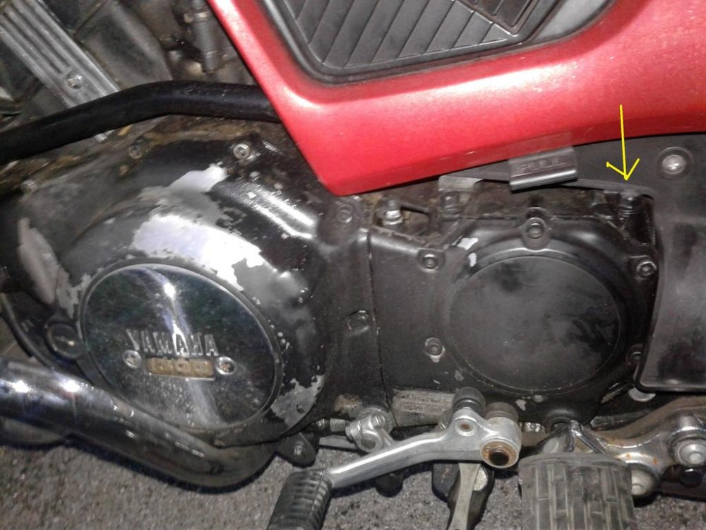

Waveracer200 Posted February 16, 2018 Share #17 Posted February 16, 2018 (edited) Hello, I recently had an issue when my motorcycle was driven for a while(and the motor got hot) that my clutch got soft on me. I eventually found out that it was leaking and letting air into my hoses for the clutch. I figured out where it was leaking from and saw it bubbling out of a bolt at the top. The rubber seal(or o-ring) seems to have dry rotted and now lets the brake/clutch fluid out but only when it gets hot.The clutch is never soft when the motor is cool. I can't find anywhere in the diagrams or online what the name of the bolt is and what it is used for. It seems it is also holding some sort of small cover to protect the engine long with keeping the brake fluid in the bike. Attached is a picture. I am hoping someone can help me with this as I have looked ever where or this. I cant get the exact names of the two cycle like covers. I found one place where someone calls it the starter clutch cover and here saying it is the middle gear cover and the parts diagram calling it the chain case. I am getting confused. In the picture, I put an arrow a one of the two top bolts the other one is not leaking but I am sure it will. You can also somewhat see where the brake fluid leaks out of it. It does not seem to be leaking out of the actual cover in the front below the bolt. I am hoping someone can help me with this answer as soon as they can so I can use this bike again to get to work and save money on gas. Edited February 16, 2018 by Waveracer200 Link to comment Share on other sites More sharing options...
Marcarl Posted February 16, 2018 Share #18 Posted February 16, 2018 Hi and Welcome The cover you have in the picture is not the clutch cover, that is on the right side, so the other side. What you have pictured is the 'stator\starter clutch' cover. The smaller cover to the rear is the middle gear cover and at the bottom of that cover, in the center is the 'leaky' bolt that is usually referred to. The bolt you have indicated does not normally have a leaking issue. I would look a bit higher to see if the leak is from a valve cover gasket, that would be more common. The bolt in question I believe holds the engine case halves together and might leak if not tight enough.No harm to take it out and check to make sure all is well under it. A no clutch issue when hot indicates air in the clutch line and it's not all that easy to get rid of. Reverse bleeding can often help with that, but first bleed it normally to make sure you have all fresh fluid in the system and got as much dirt out as possible. Link to comment Share on other sites More sharing options...
Condor Posted February 16, 2018 Share #19 Posted February 16, 2018 Carl, I'm thinking that maybe the crank is over full, or excessive crank pressure might be the cause of oil coming out from around that screw... beside it being loose as you already mentioned. I would think from the pics of that bike it probably has a few more issues that just the leak...?? Link to comment Share on other sites More sharing options...
Flyinfool Posted February 16, 2018 Share #20 Posted February 16, 2018 The bolt that you are pointing to has nothing to do with break/clutch fluid The slave cylinder is behind that bottom most point of the side panel. If you have something bubbling out of the bolt that the arrow points to, it would have to be engine oil. As mentioned it sounds like you have several unrelated issues with the bike. Old fluid will give a spongy brake or clutch and it will get worse with heat. Pop the cover off of the clutch master, the fluid should be water clear, If it is not then do a flush of the system. Just keep bleeding it until the fluid coming out of the bleeder is water clear. Make sure that you do not run the master dry in the process. If you do get air into the system it can be hard to get out. This goes for the brakes also, if the fluid is not clear change it out. Use sheets of plastic and some towels to cover the bike, the tiniest spec of brake fluid will eat a big hole right thru the paint and or plastic parts of the bike. As for the oil by that bolt, there is some other issue causing that leak. Link to comment Share on other sites More sharing options...
7 lakes Posted May 7, 2018 Share #21 Posted May 7, 2018 Not to add to your misery, but you need to service the internals in the clutch hydraulics and probably the brakes too, from the look of your photo. The condition of the internal surfaces and wear parts of the clutch and brake are going to be just as bad as the fluid was. Draining nasty old fluid and filling with clean new fluid will be a temporary help at best. Link to comment Share on other sites More sharing options...
