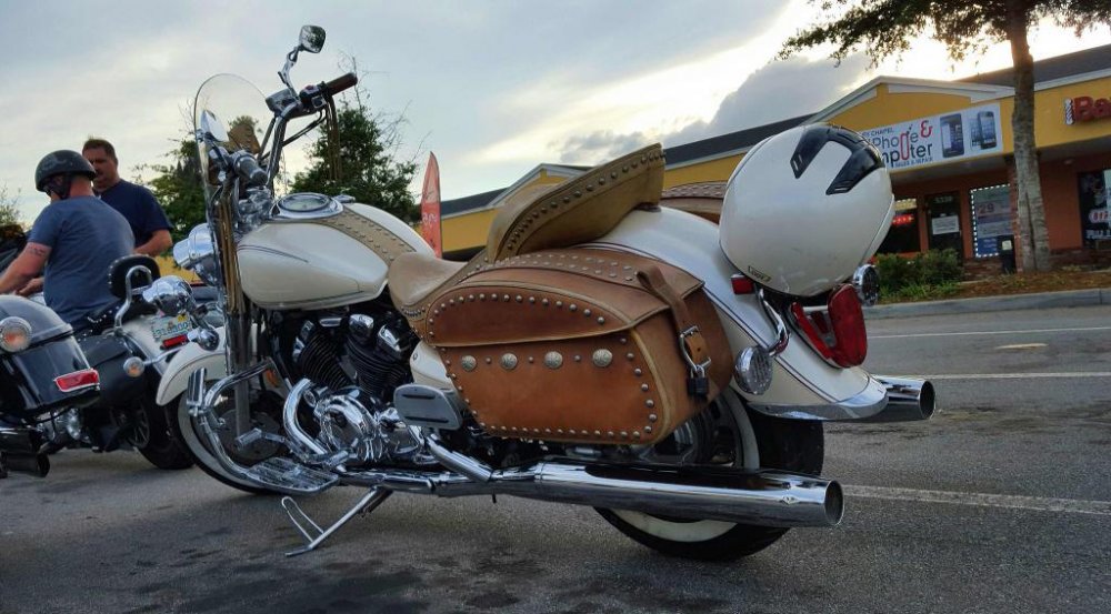

It had Vance & Hines 4-into-4 pipes on it (which sounded AWESOME), but they were in bad shape. V&H no longer makes pipes for this bike, and we couldn't even find factory pipes unless we bought an entire donor bike! We landed these 4-into-2 pipes on eBay; they came off a 2005 Venture. My husband had to make brackets to hold the mufflers, but otherwise, they bolted right up!
We are looking for several chrome pieces for this bike, but they are getting difficult to find!

The leathers are looking rough, especially the seats. There has been much discussion around our house about whether or not it's worth it to try to find new old stock in the original tan, or have them redone or replaced. I'm seriously considering putting an Ultimate seat on it in the tan colors. It won't be original, but it would retain the look, which is why I bought it in the first place. I've had it since 2000.
Is a Palomino edition worth any more than any other Royal Star, or is it just a pretty conversation starter?
Link to comment
Share on other sites
Back in the day, Yamaha contracted with Bushtec trailers to come up with some customized Royal Stars for a few years (2 or 3), they were very limited editions, the Palominos were some of those bikes. Like anything in this world, they only worth what the next guy is willing to pay, but for a true Royal Star nut, they are often sought after.
There is a member here and on Delphi Royal Star forum that re covers seats, I am sure Woody would do a great job, and he is here in the central Florida area, in or near Orlando. If you are interested I can find him for you.
