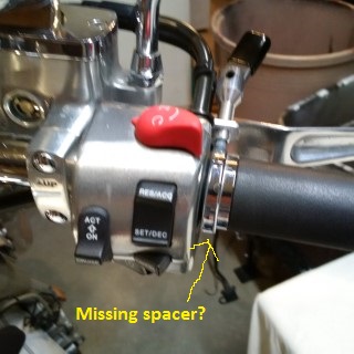

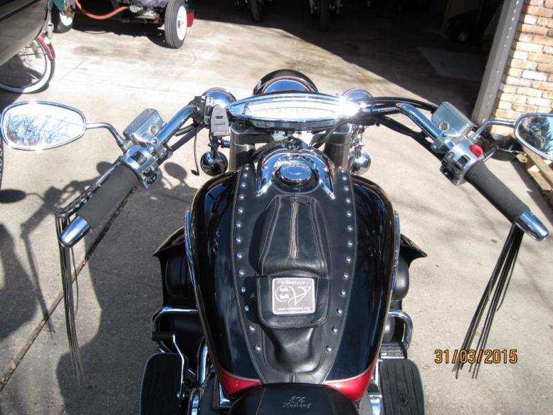

eagleeye Posted March 31, 2015 Share #33 Posted March 31, 2015 (edited) usnmustang, phoneman, and primebeef, I want to thank you all for your posting on how to install, bars and end weights. I put the flanders bars on last week and the bar end weights today. Haven't taken it out on the road yet. Still lots of sand and salt here, but the next week should take care of all of that. They really feel great just sitting on it. BTW mine is an 05 RSTD Ok, so yesterday took it out for a couple hour ride and I like the bars but they will take a little getting used to. They definitely put you back in the seat. The pull back if very noticeable but I think that I might just raise the bars up a couple of inches. The middle of the bar end weights are 36 1/2" from the ground. I wish I could remember what my stock bars were. Anyone's measurements would be appreciated, either stock or Flanders. One other thing, my throttle doesn't go back to dead idle. Seems to stick a little, so I'm not sure where to look to solve this issue. Not a big deal but not quite right either. Edited April 3, 2015 by eagleeye added info Link to comment Share on other sites More sharing options...
Leland Posted April 5, 2015 Share #34 Posted April 5, 2015 You seem to be missing the spacer. Link to comment Share on other sites More sharing options...
eagleeye Posted April 5, 2015 Share #35 Posted April 5, 2015 You seem to be missing the spacer.[ATTACH=CONFIG]98554[/ATTACH] Thanks for looking out for me, but I have grip puppies on and they just cover up that spacer. It turns with the throttle so doesn't matter. After time they tend to slip down, so I just put them on a little farther. Link to comment Share on other sites More sharing options...
