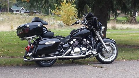

Bsintheair Posted March 23, 2015 Share #13 Posted March 23, 2015 I used a Matuza HD Tour pack with lights, and a Venture trunk rack. Added rubber stoppers under the trunk to take up the space between it and the rack. Ordered a Die-cut YAMAHA sticker to put where that other name usually goes. And a wiring harness from Steve (http://www.venturerider.org/forum/members/m61a1mech) to power it up. Link to comment Share on other sites More sharing options...
