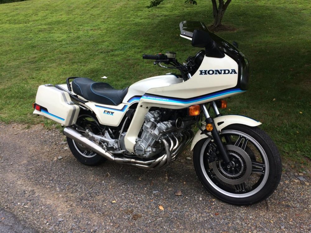

That is a nice looking 82. Those were the days, when you could buy them for 1000. I picked up a couple at that price. This is exactly why I an debating weather or not to sell my 82.
Did I understand you correctly, you got offered or you sold this bike for $16k. How long ago was that. I see the condition and mileage but did not think they were selling that high.

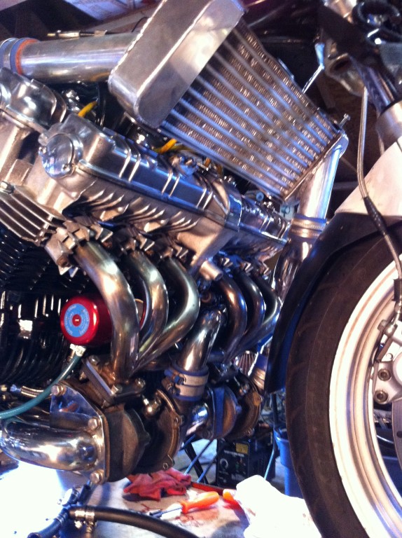

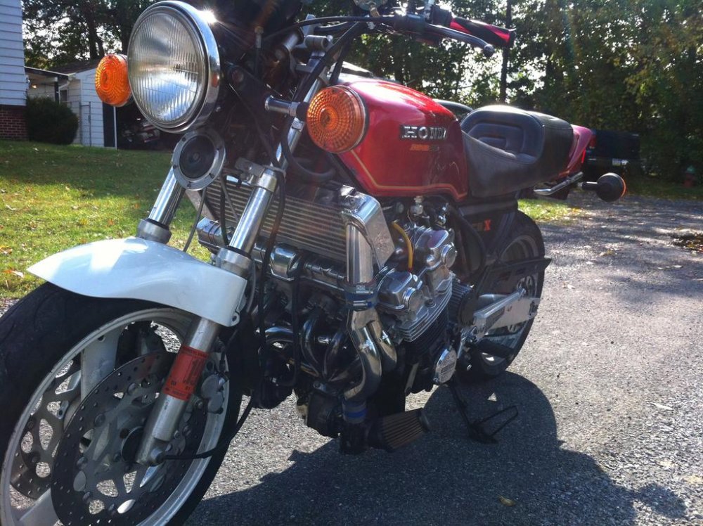

This might answer your question and get the conversation started I have had my CBXs longer than my Venture and the forum support is very good like it is for the Venture. I cannot see owning a CBX without the support of the ICOA and others forums. I have my 82 up for sale on craigslist and cycle trader. I hate to sell it but I had not been riding it. I put a built up 79 motor in an 82 frame and it is really a nice ride that draws a lot of attention if you go anywhere with it. I have been building the twin turbo for over 10 years now and since I got it running and on the road I have decided to focus on it and sell the 82. At least that was the plan. If no one want to buy the 82 I really won't be that disappointed now that it is back on the road also. It sat for 10 year until last summer when I decided it needed to be sold. I pulled all the parts together and got it running with the hot motor and 6 into 1 pipe and now I am thinking twice about selling it.
