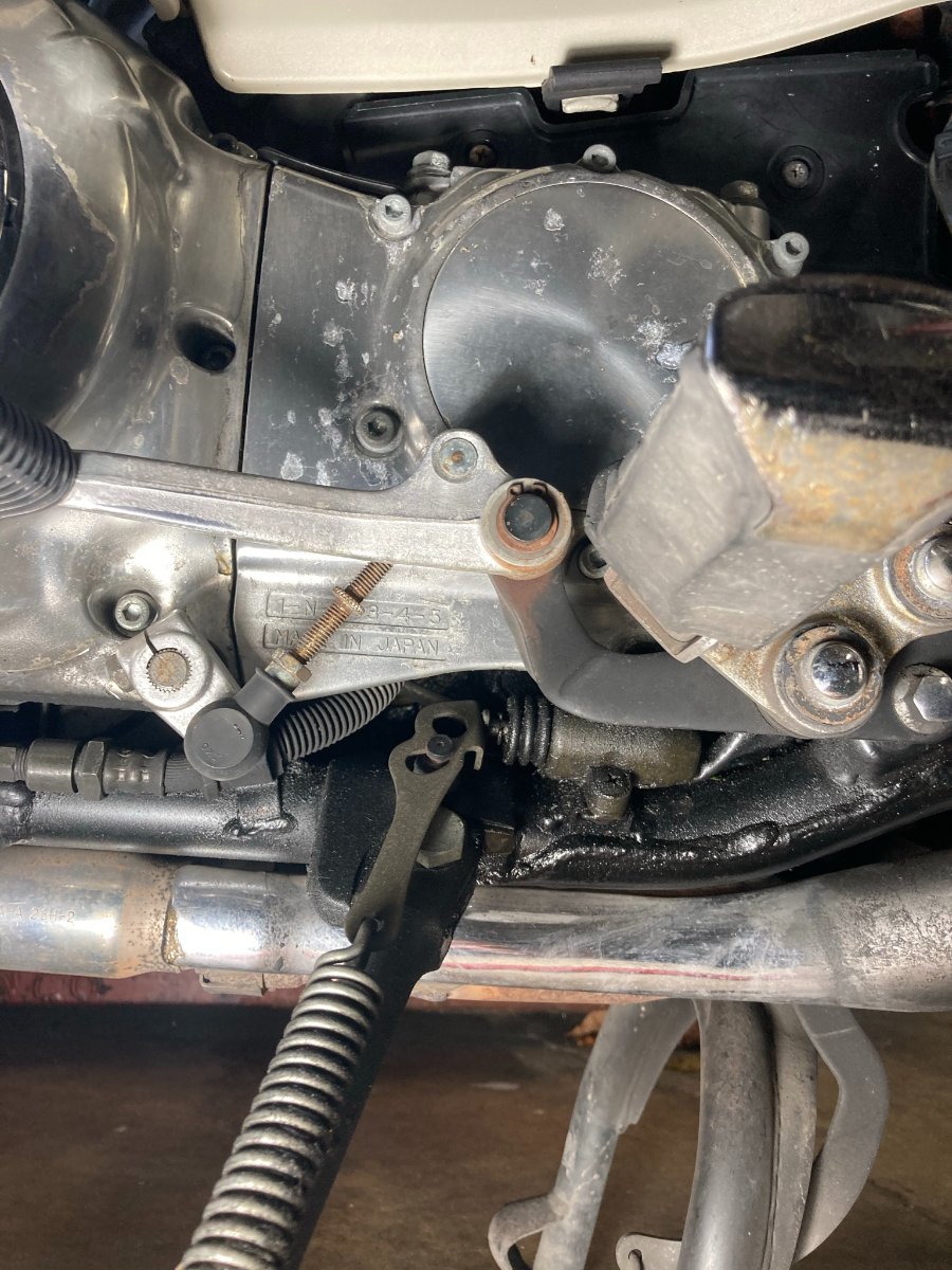

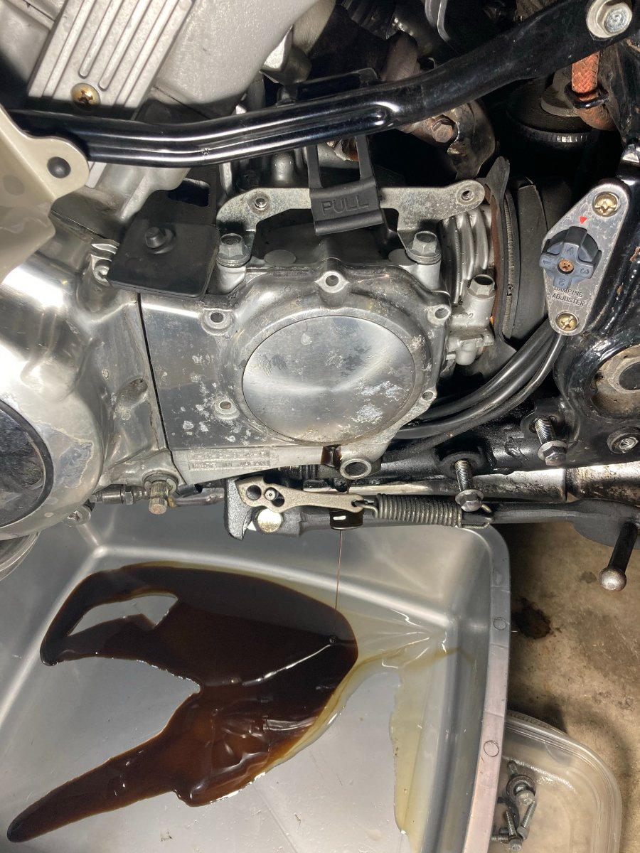

well talk about learning something new every day. I did not notice a leak but after looking at the manual and seeing no other place back there where a seal could be leaking I went back out to the garage and mess is really under that bolt and not so much the rear end of the "Middle Gear" where it exits the back of the motor. Could it really be this simple. I try the anneal process. Sounds simple enough and worth a try. At least if I clean up the area I can then watch for evidence of the new leak -
Developed an oil leak that I am not sure where it is coming from. This is an 88 with 90k on it and this leak just showed up this summer. See photos. I started taking things off and got to the "Middle Gear Bearing Cover" and took the bolts out. The cover is till glued to the block but as I took out the lower bolts a small stream of motor oil began running out. So far only about 3 oz have drained. Clearly this is a gasketed surface so where did this oil come from. None of the bolts had oil on them. I just looked at the photos again and it looks clear that the oil came running out the lower center bolt. I did have the drive shaft and differential off but did not look at the rear drive seal. I am thinking that is good possibility also. That is going to require a bit more disassembly to get a look at. That is where I at for the next few days. Any thoughts?
