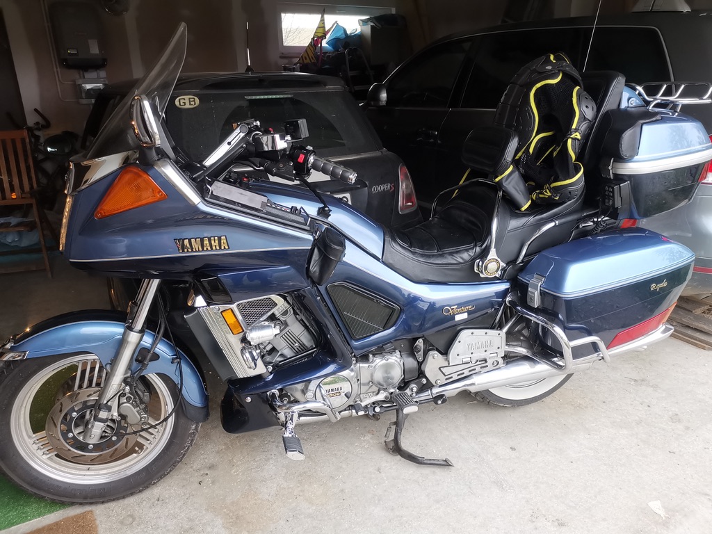

Does anyone please have any info on the correct name or code number for the darker blue on my Royale. Needs a few touch ups.
Spring has finally sprung in my corner of Poland. Around 350 kms under the tyres so far. With each km I have come to love and respect my 2 wheeled lady more and more. In short this bike is fecking amazing, I wasn't sure when I bought it, but any doubts have been dispelled and then some. I sincerely hope that both I and all the other Venturers on here get a chance to convert fuel into smiles over the next several months, despite the current difficulties. Paul
