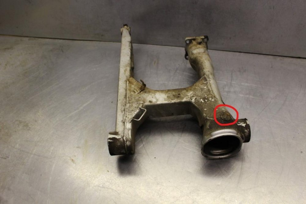

cimmer replied to snyper316's topic in Venture and Venture Royale Tech Talk ('83 - '93)
The hole has a plug in it and sits on top of the swing arm right above the U-joint. I found a photo of a swing arm and have circle the plug for you. Just pop out the plug and you have access to the U-joint in there and I have also had luck pulling bback the rubber boot and then taking a screwdriver or drift and inserting it between the u-joint and yoke and that can help to align the u-joint and the driveshaft for easier insertion. Hope that helps. Rick F. -
