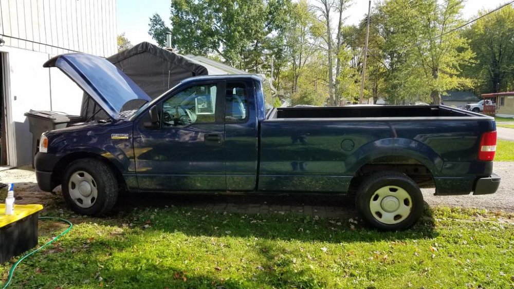

Well, the rust on the fenders is worse than I'd hoped at first glance. After flaking of the loosest paint, And after hitting it with the wire wheel, This is going to take more than a bit of bondo to smooth out! Ah well, what's that old line about plans, mice and men? -

Parking brakes are fixed! Funny thing is the rotors and pads are brand new and the disc hardware was all new and lubed nicely. Who ever did it did a nice job. I wonder why they left the drum park brakes all discombobulated? I did use the new springs and adjusters. The old ones were pretty bad. It was exactly what I had found described on several forums and a couple youtube videos. The actuator levers were seized up and the cable had come off the lever hook. A few minutes on the wire wheel and a bit of light file work later they work just fine. They may need adjusted but I'll take to a shop with a rack for that. It's tough to get them even on the ground, one wheel at a time. -

I got the cruise control figured out. It works, there's just no "On" indicator. I get the green "speedometer" icon when it is on and set but nothing at all when it is on but not set. So, from startup, hit the on button once(no indicator at all), get to speed, hit the set button and the green speedo icon pops on. The coast and set buttons adjust the speed setting and it holds speed properly. Hit the brake or clutch or step on the throttle and the icon goes out and the cruise drops out. Hit the resume and the icon pops back and the cruise reverts to the last setting. It's working right, just no "On" indicator. I bought the E Brake spring and adjuster kit this morning, but I probably won't need it. It sounds like a good cleaning and some anti seize is all that is usually needed to restore the parking brake to operation. I'll be tearing into that and working on the rust spots later today. I'm not going to put the effort into it to make it look new but I want to halt the rust and at least make it look semi decent. A wire wheel, Loctite rust neutralizer, primer and a close match touch up paint should do the trick. I may go so far as to use a little Bondo on the fenders if it's pitted too badly after I scrub it with the wire wheel. -

I had about $300.00 in petty cash set aside for some upgrades and repairs on The Beast this down season. I used it today for a down payment on a 2007 Ford F150 long box. I really needed a "new" truck. My POS '96 Ford Ranger was on it's last legs. Hell, it'd been life support for the last few years. Besides, getting the Venture in the bed was darn near impossible and it looked really funny when it was. Any Ford folks? I have a couple questions. This is the XL package with the 4.2 L V6, manual 5 speed transmission and no frills. The steering wheel has the cruise control buttons but they do not work. Does the manual version actually have CC or is this a replacement steering wheel? The E Brake does nothing. I think I have found out why in a cursory web search but if anyone here has any insight or words of wisdom, I'd love to hear from you. Not the best pic, but here she is. There's some rust over the rear fenders, but not rotted through. There are a few spots on the front corners of the hood that don't have any rust, but the paint is flaking off an the clear coat on the doors, over the windows is peeling. Not bad at all for a 12 year old truck in Ohio. The frame is solid, suspension is good, steering is tight and the engine runs quiet and strong. Looks like a brand new alternator and passenger side lower control arm.
