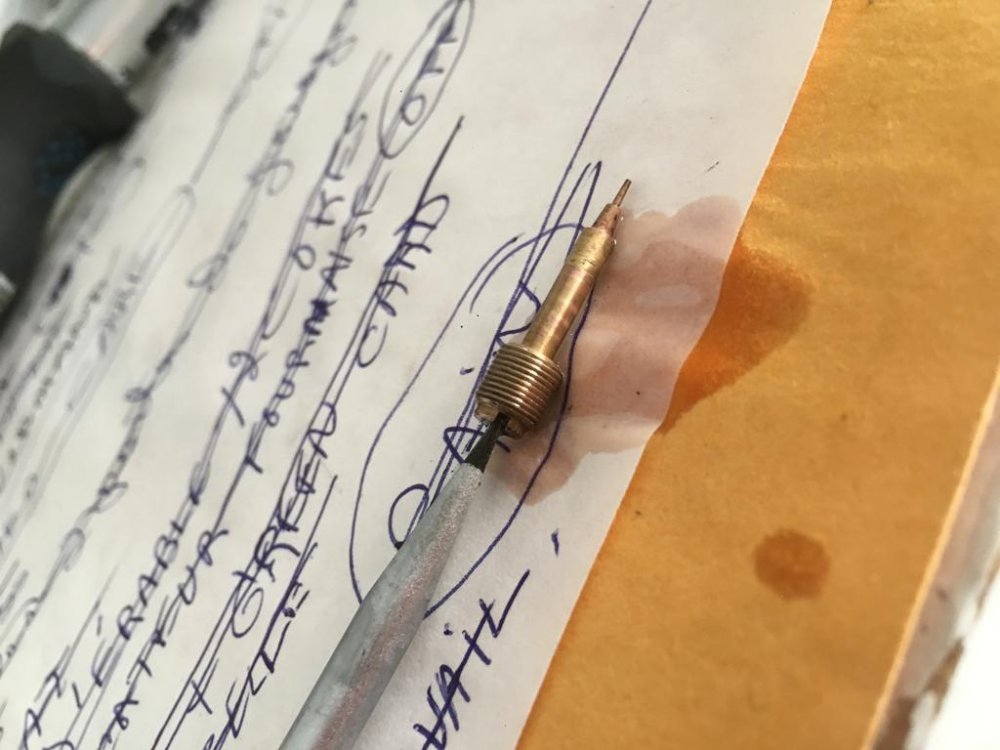

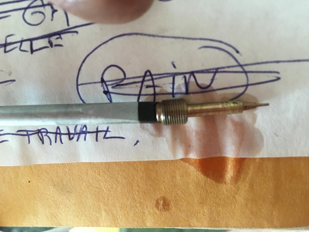

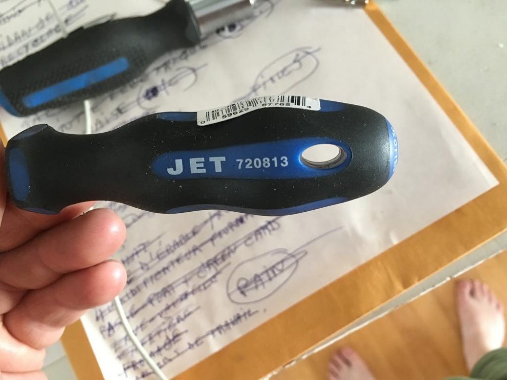

Two of the 8 carbs I been working on the a/f screw was completely seized. One I got out but another the head of the screw stripped and it's stuck in there forever I guess, never to be adjusted again unless I tackle it with an easy out. For this reason it's important to me that the tip of the blade fits into the slot on the screw dead on with little or no play. That way when you twist on the driver, the whole blade is making contact with the whole slot on the screw, minimizing your risk of stripping the head.
