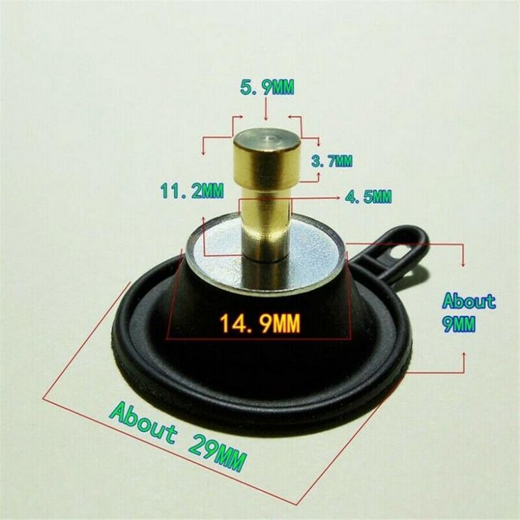

Carb diaphragm replacement question
jfman replied to bobber's topic in Venture and Venture Royale Tech Talk ('83 - '93)
Are we supposed to glue the diaphragms on or glue the metal sleeve to the plastic piston? I installed new diaphragms and the metal sleeves seem to snap right into the plastic piston and hold fine but I am wondering if I was not supposed tu use glue or sealant to permanently hold it together. BTW I ordered the diaphragms from china at 5$ each on fleabay. I have yet to ride the bike but am happy with the fit. -
