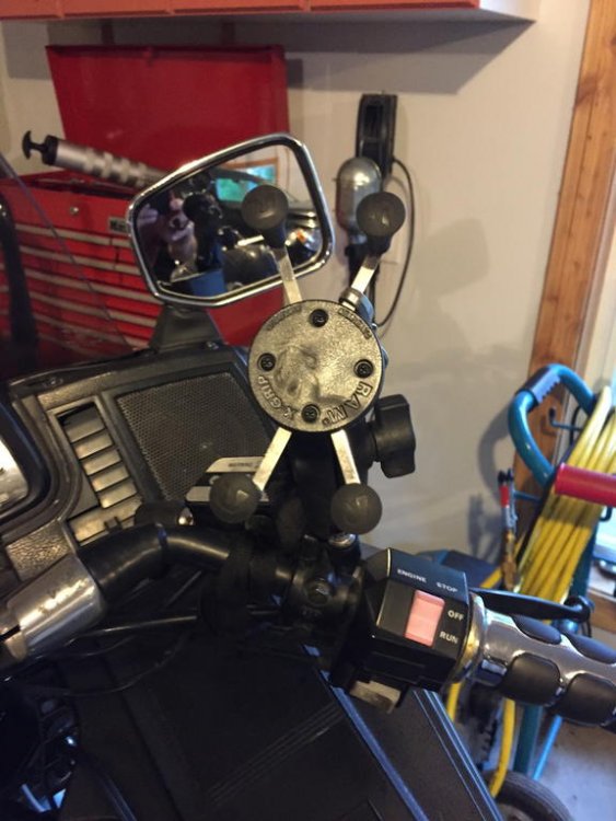

I installed a RAM mount to hold my iPhone. Holds the phone very securely on the roughest of roads. The downside is that it's hard to see except in the darkest of days, and vibration doesn't help. Fortunately, I'm able to connect to the iPhone via my wireless headset, so more often than not I just toss the phone in the dash compartment and go by sound.
