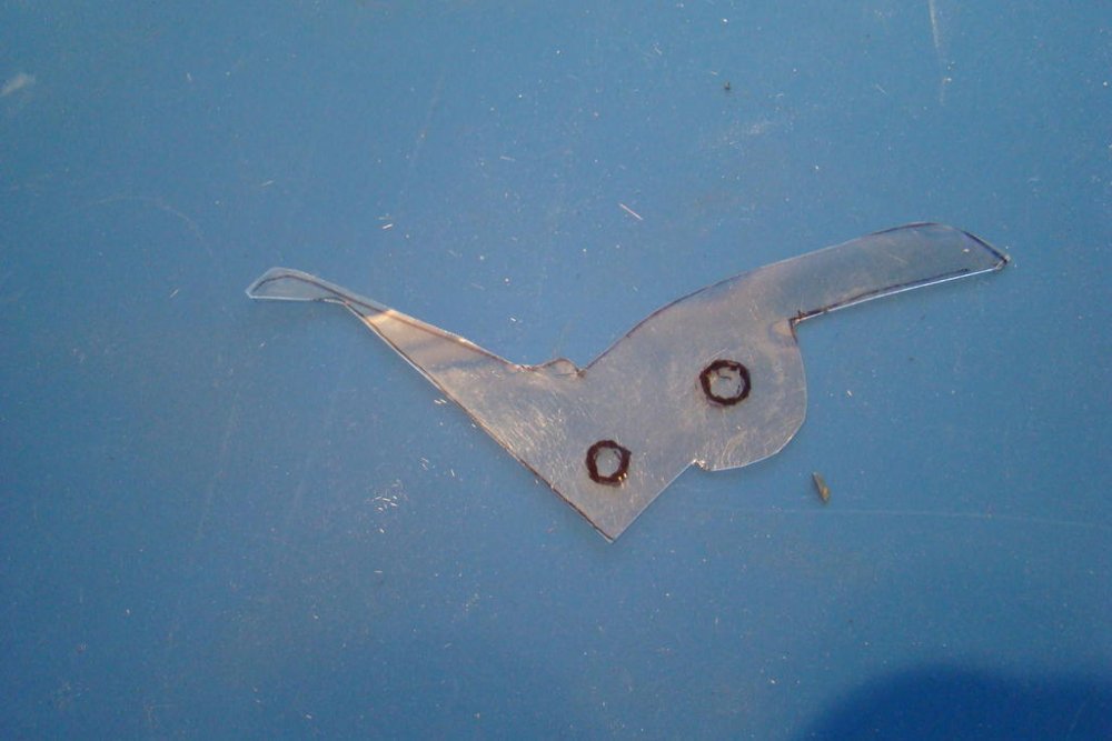

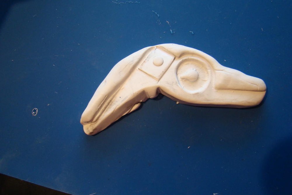

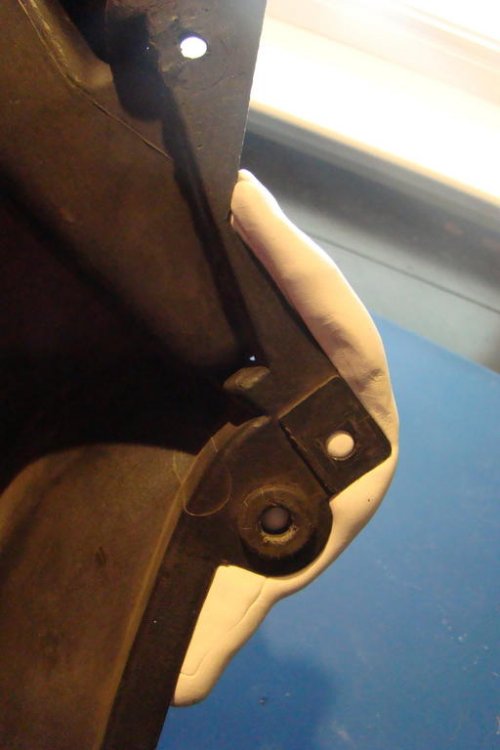

My wife has continued to work repairing plastic parts on my '84 Venture. I thought I'd illustrate how she was able to repair a major break on the right-side upper panel. At the rear end of these panels are two grommet holes that hold the body side panels in place. On the right-side panel, the plastic containing the holes had completely broken off. See pic of unbroken left side and broken right side. Using the unbroken left side panel, and some non-hardening modelling clay, she was able to make a mold of the missing part. With the mold as a guide she cut a template using a thin sheet of clear plastic. With the template as a guide she cut out the repair piece from a sheet of ABS using a scroll saw. Then, using ABS cement, glued it to the panel, and eventually backed it with fibreglass and epoxy. The slot for the spring washer had to cut out with a Dremel tool. All I need do now, is order up a couple of grommets and a spring washer. -

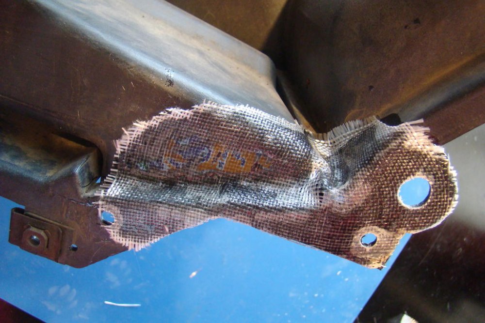

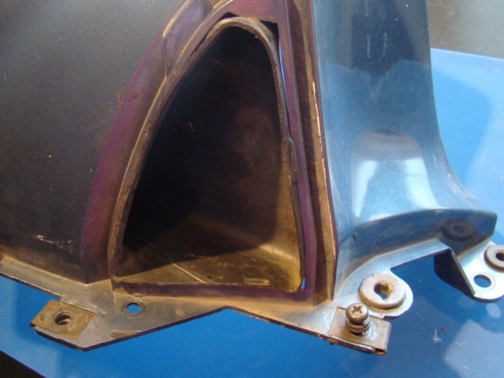

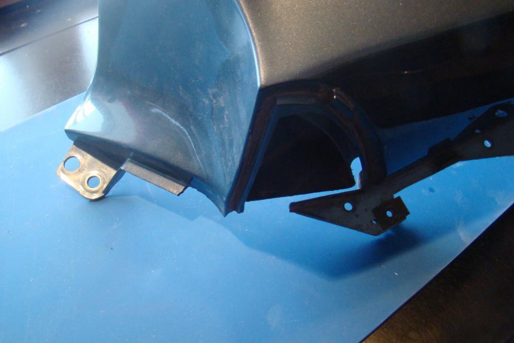

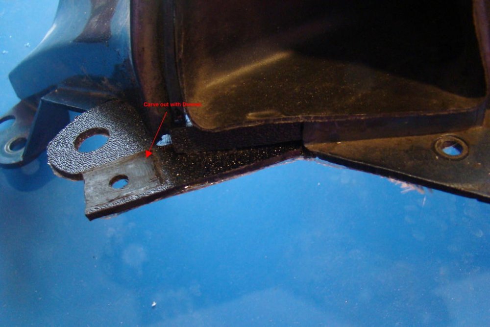

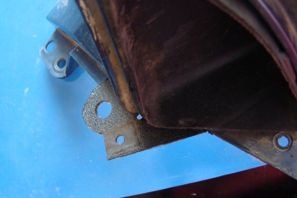

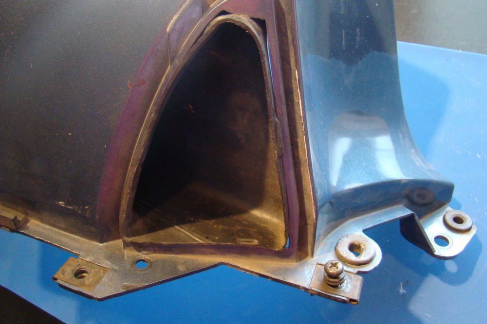

A number of posts on this site, and others, provide some pretty good guidance on repairing the brittle plastic that these old Ventures are covered with. Using that info, I had my wife tackle some tab repairs, seeing as she has a lot more finesse with her hands than I. Here's a picture of necessary materials - ABS plastic sheet, epoxy, and fibreglass. Missing from photo is a can of ABS cement, and a fine tip, electric soldering iron. Cracks can be repaired using a combination of soldering iron to widen and deepen cracks, fill with ABS cement, and then fibreglass-epoxy backing for added strength. Where pieces, such as tabs, are missing completely, replacements can be cut and fashioned from the ABS sheet, and then attached with ABS cement and fibreglass. Hopefully you can use any existing, complete tabs as a template. Here are some repair results on lower fairing tabs. This seems to have worked well. It will be interesting to see how these hold up.
