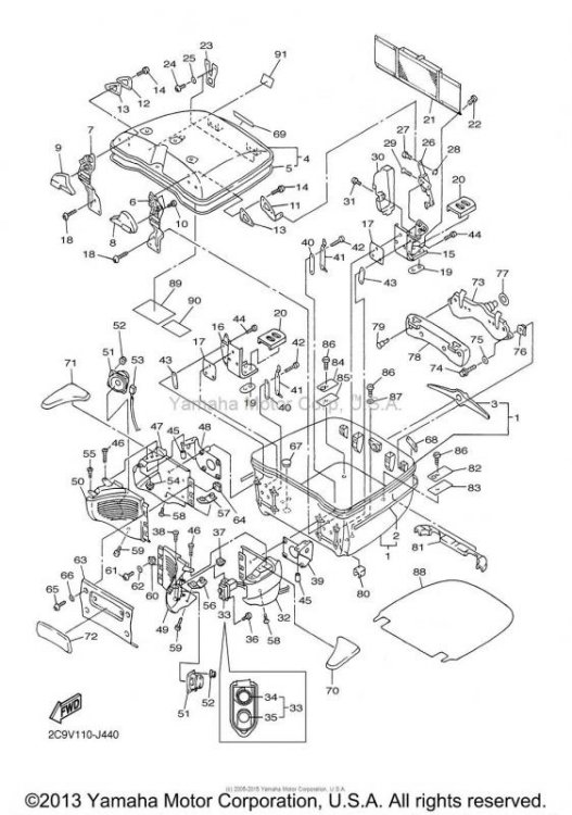

Remove push pins on cover by pressing in on center head with toothpick, ball point pen, etc, and remove cover. Unbolt part # 73 from trunk. Once you get part # 73 in your hand the lock cylinder will unbolt from the plate. -

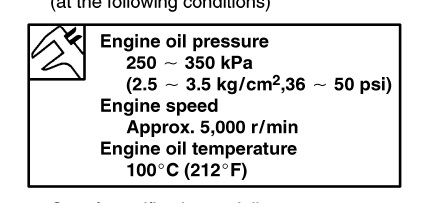

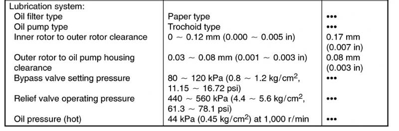

What weight oil are you running? Something don't sound right. What readings do you get if you run gauges ground straight to battery?
