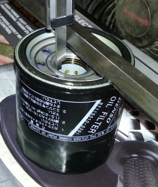

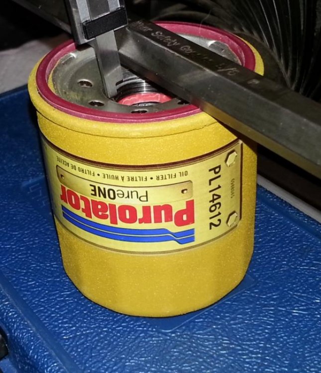

I have recently heard of two reports of a Purolator PL14612 not screwing on far enough to make a complete seal. Seems to work ok on my RSV so far... I will keep an eye out. The factory 5GH-13440-30 has a gasket to first thread depth of 0.300" The Purolator PL14612 has a gasket to first thread depth of 0.235" which is 0.065" less than a factory filter, (I know the caliper is crooked in the picture but I measured it before I took the pic.) I would suggest that you first make sure that the Union Bolt is tightened to 36 ft lbs and if you still can't get a seal it may be time to look for another filter. I have not yet had the chance to measure the depth of a PL14610. Anybody else have one they could look at and tell us?
