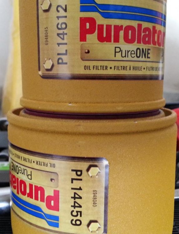

Purolator PL14459 Oil Filter
Du-Rron replied to Du-Rron's topic in Royal Star Venture Tech Talk ('99 - '13)
Yes, in fact since its diameter is more than 1/2 inch greater than the PL14612 or the PL14610 it will hold A LOT more oil. More than even the PL14610 (long filter). Remember that it is > 1/2" wider for its entire height. Its circumference = diameter X Pi - or.... yes buckets full of oil. Plus since it is wider it is easier on the hands to get on and off. The white filter is shown below and this documentation is available from the Purolator website. The Pressure Differential Valve opens at (X) pressure on a filter when the filter element is clogged and can then flow no more oil through the element, or, your oil is so thick that the oil cannot properly flow through the element such as after a cold start, or, you have just gone from idle to full-wheelie mode from 1000rpm instantaneously to 5000 rpm and the oil on one side of the element has not yet reached equilibrium pressure with oil on the other side of the element. In these cases, the Pressure Differential Valve OPENS and keeps your engine from losing oil pressure or flow rate. You really never -*want*- the Pressure Differential Valve to open as it flows unfiltered oil to your engine and this is done as a last attempt to keep oil going to your engine and NOT being blocked by the oil filter. As soon as the pressure on one side of the filter comes to within (X) of the other side of the filter the Pressure Differential Valves closes and oil is then passed only through the filtering medium to your engine. Yamaha has a spec for this as shown in the post above. The PL14612/L14612 are on the high end of this spec. The PL14459 is in the medium area of this spec. The neat thing about all three of the Purolator Filters (or 6 if you count the white ones) is they all have a much higher flow rate than the factory Yamaha 5GH-13440-30 PL14459= Short FAT filter. Yup, holds more oil than the PL14612 at least as much as PL14610, and acres more than a PH6017A -

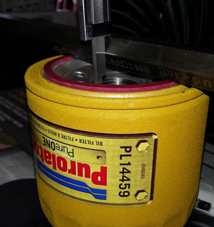

Hey Rocky... Watch me pull a rabbit out of my hat. OK, to confuse the oil filter issue even further, I intend to use a Purolator PL14459 on my next oil change. The PL14459 is the same height as the PL14612 The PL14459 is fatter than the PL14612 and we all have plenty of room in the horizontal & vertical directions, just not the longitude. The PL14459 gasket ID & OD diameter is the same as the PL14612. The PL14459 gasket to 1st thread depth @ 0.300" is the same as a PL14612 The PL14459 has a Pressure Differential Valve setting of 12-15 psi compared to the PL14612 setting of 14-18 And these specs conform nicely to the Yamaha Factory Requirements.
