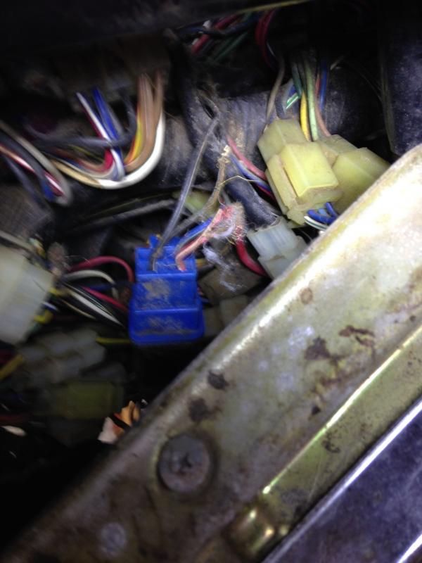

Patmac6075 replied to Patmac6075's topic in Venture and Venture Royale Tech Talk ('83 - '93)
That's it! Thanks! Could a couple of wires being disconnected from this cause a No Spark issue? I thought if the side stand circuit was broken, the engine would not spin at all? -
Just thought I'd vent for a moment, So, have been working on my still not running '84 VR...I currently have most of the fairing opened up, and as I was rooting around in there I noticed a quite sizable mouse nest (actually saw it in the Fall, but put off cleaning it out till now). Well, as I was cleaning things out I noticed this: Looks like the little bugger spent some of his vacation chewing on my wires! This is directly behind the headlight...Does any body know what this blue relay(?) is? I seem to remember the guy I bought the bike from saying his grandad (Grandad was the actual P.O., but had passed away some time ago) was having some electrical issues and that's why the bike was put into storage. Well, here's the tricky part. Before I began tearing the bike down (ultimately to get to the TCI, valves, and carbs) I had checked the electricals....ie., the headlight, taillight, brakes, CLASS, ect. And everything was working fine...except the bike wouldn't fire (would turn over fine, but wouldn't fire. Wasn't getting spark). Again, does anyone know what this is? What it controls? Could it cause a No Spark issue? FYI - there looks to be a couple of other wires (partially chewed), that will also require some attention. So they could be the culprit as well. Cheers Pat
