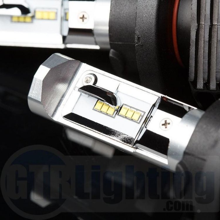

videoarizona Posted May 2, 2018 Posted May 2, 2018 Also, what turns me off is there is no provision for blocking off the low beam....so the LED is relying on the lens to do that and that probably won't work. If you look at quality LED bulbs for auto use, the low bean LEDs have a piece of metal blocking off the light so it throws a flat pattern out to the horizon. The Broviews a number of us bought has that as well as the recent post that showed a picture of the bulb cutoff. I've included a picture of the cut off plate. DO NOT BUY these as they are not for us.... Hope this helps
