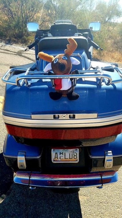

2nd question: I got a Christmas Elf for the RSV..."V4".
Trying to come up for a name for my Holiday Moose... On the VR. "G1" maybe? Suggestions?

Had a moose ride on the back of my 85 for quite a few years and then this year after our trip to Minden, moose country, there she was,,, GONE!!!

As far a name for your riding partner,,,, :scratchchin:,,,,, looking at the direction he is facing and knowing what he will probably see back there,,, how bout HOG KALLER :banana:,,,,, and we friends of Hog Kaller will just call him HoKy:biker:
GREAT PICS!! Thanks Vaz!

Think I'll stick with "G2" for the moose name. I like Puc's suggestion, but my HD buddy might not smile!! And we do ride together as often as we can...
