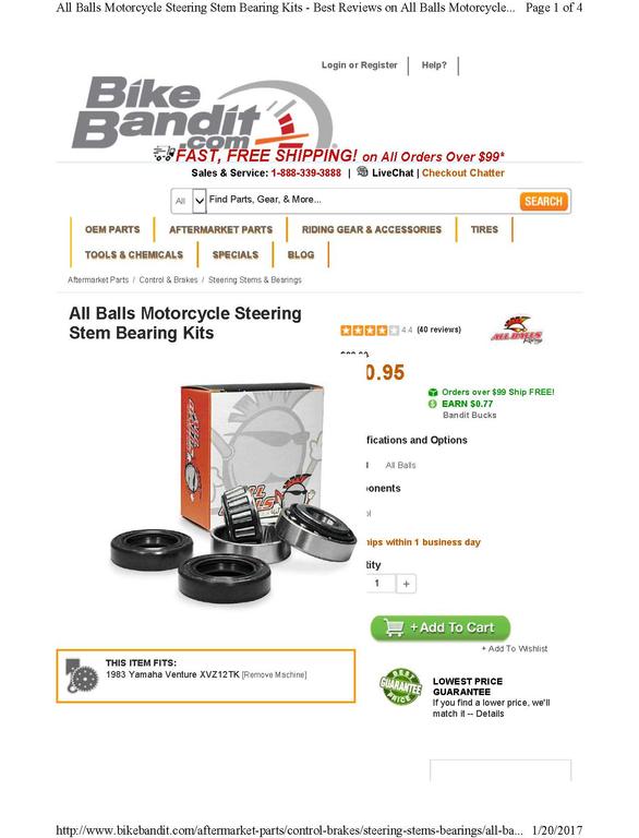

Matt_P Posted January 20, 2017 Author Share #52 Posted January 20, 2017 right? thank you guys for advice, as I am a tactile person had to do a bit of youtubeing to find out what yall where talking about haha. figured it out.stee.pdf Link to comment Share on other sites More sharing options...
bongobobny Posted January 20, 2017 Share #53 Posted January 20, 2017 That's the brand I used, but not that kit. I bought mine separate. The kit package is probably less expensive. Bike Bandit is a good company to deal with. Link to comment Share on other sites More sharing options...
Matt_P Posted January 20, 2017 Author Share #54 Posted January 20, 2017 That's the brand I used, but not that kit. I bought mine separate. The kit package is probably less expensive. Bike Bandit is a good company to deal with. do you mean you buy the bearings and races separately? Link to comment Share on other sites More sharing options...
bongobobny Posted January 20, 2017 Share #55 Posted January 20, 2017 do you mean you buy the bearings and races separately?No, bought each bearing and race, which is almost always sold together, separate... Link to comment Share on other sites More sharing options...

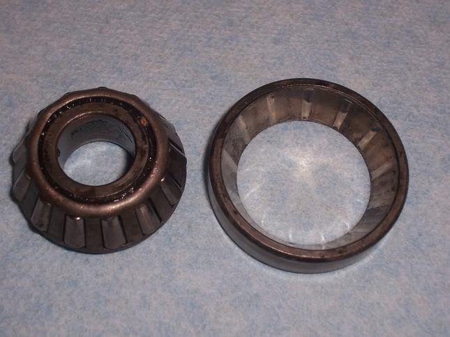

Matt_P Posted January 21, 2017 Author Share #57 Posted January 21, 2017 In most cases, couldn't you just clean and repack the existing bearings? Doesn't seem to me they would get much wear. I could, but from what I read and seen, the bearings wear thin grooves into the races. Im sure mine haven't been lubed in the last 20 years. So replacing them to get mine up to normal maintenance standards might be the best option. ill post pics of what they look like when I get them off. Link to comment Share on other sites More sharing options...
Wilzhere Posted January 22, 2017 Share #58 Posted January 22, 2017 I could, but from what I read and seen, the bearings wear thin grooves into the races. Im sure mine haven't been lubed in the last 20 years. So replacing them to get mine up to normal maintenance standards might be the best option. ill post pics of what they look like when I get them off. in my 45 years and the many bikes Ive have the stem head bearings don't really get damaged from turning left or right they get trashed by hitting pot holes and such, even them road dividers. its up and down damage forward / back movement. this is a picture of a bad bearing/race that needs to be replaced. these were mine and i was bottoming out on the forks all the time or so i thought, so i tore down my entire front forks that weren't leaking and held air, pulled springs thinking i would need progressives but i read that Yamaha springs are 18 inches in length from factory, mine measured 17 7/8 ths. no need for new springs saved me some money, shined up my forks with 2200 grit sand paper to remove any nics in the tubes, changed out the fork seals and the triple tree stem bearings and been great for 2 years now. used Yamaha seals and All Balls bearings. if your bearings look like this replace them, i also found that i did have a side to side wobble when i first got the bike ...this took care of that also.. I now have a great front end...with working anti dive. Link to comment Share on other sites More sharing options...
bongobobny Posted January 22, 2017 Share #59 Posted January 22, 2017 Yup! A picture is worth a thousand words there!! Also, after that many years, the grease tends to turn into something more like glue... Link to comment Share on other sites More sharing options...

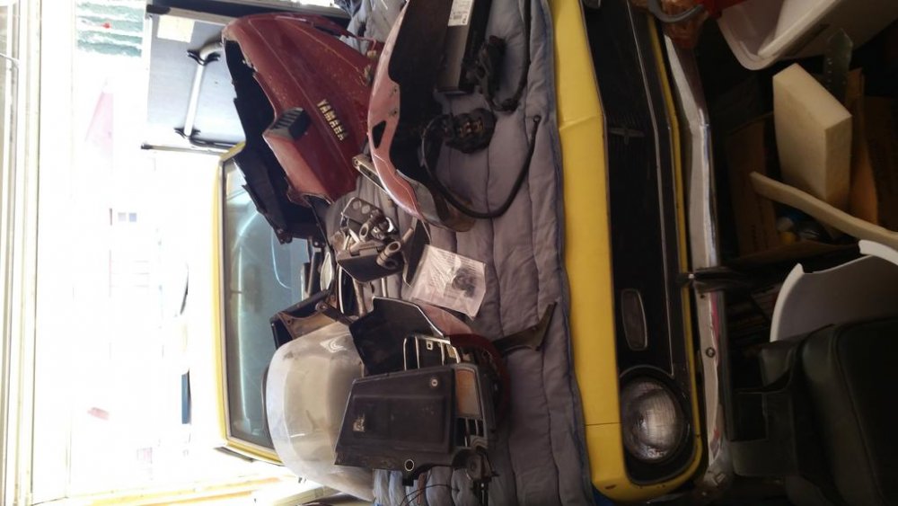

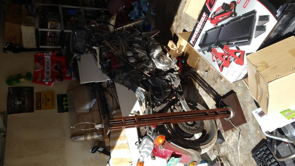

Matt_P Posted January 29, 2017 Author Share #67 Posted January 29, 2017 pictures are bad sorry heres a update Link to comment Share on other sites More sharing options...

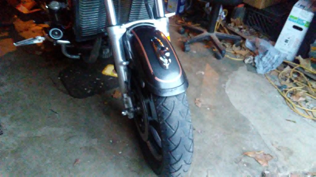

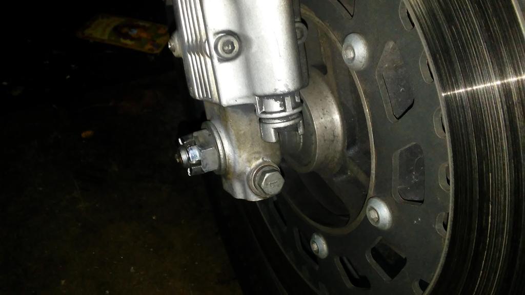

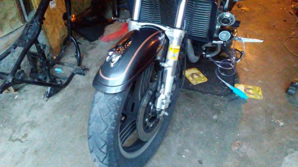

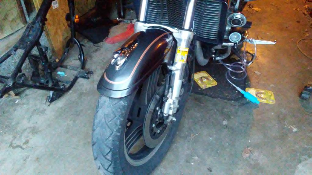

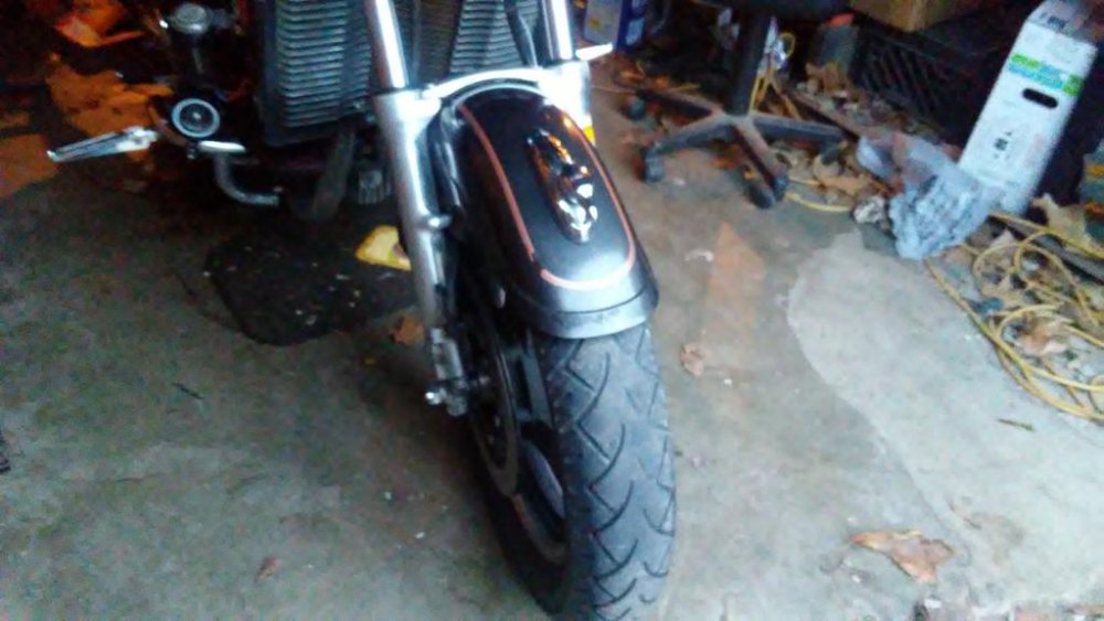

Matt_P Posted March 12, 2017 Author Share #71 Posted March 12, 2017 Will some one please post a picture of the front tire. I think I'm missing a spacer buy I don't know what it is suppose to look like. Thank you!!! Link to comment Share on other sites More sharing options...
snyper316 Posted March 13, 2017 Share #72 Posted March 13, 2017 Will some one please post a picture of the front tire. I think I'm missing a spacer buy I don't know what it is suppose to look like. Thank you!!! Hopefully I ain't too late to the party. I will go get one I guess your needing axle? Link to comment Share on other sites More sharing options...
snyper316 Posted March 13, 2017 Share #73 Posted March 13, 2017 Link to comment Share on other sites More sharing options...
Matt_P Posted April 5, 2017 Author Share #74 Posted April 5, 2017 http://www.venturerider.org/forum/attachment.php?attachmentid=108676http://www.venturerider.org/forum/attachment.php?attachmentid=108677http://www.venturerider.org/forum/attachment.php?attachmentid=108678http://www.venturerider.org/forum/attachment.php?attachmentid=108679 Thank you!! i love the adornment on the fender!! Link to comment Share on other sites More sharing options...
