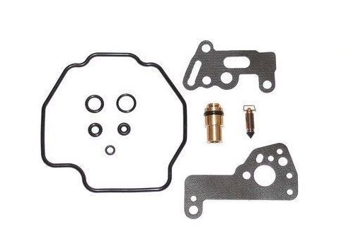

Guys i need some help..Has anyone used these parts to rebuild a 83 ventures carbs, i dont need the float needles/ seats. just the gaskets. really just the jet block gaskets and 0-rings, all my float bowl gaskets are in good shape. these look identical ....has anyone tried to use these? are they interchangable? 1985 [TABLE=class: cms_table_fTbl] [TR] [TD][/TD] [TD]Yamaha[/TD] [TD]Vmax 1200[/TD] [TD] any ideas? I've tried punching my own gaskets with no sucess, cant find the right gasket material. Must be another YAMAHA trade secret.[/TD] [/TR] [/TABLE] Thanks Wil
Guys i need some help..Has anyone used these parts to rebuild a 83 ventures carbs, i dont need the float needles/ seats. just the gaskets. really just the jet block gaskets and 0-rings, all my float bowl gaskets are in good shape. these look identical .... 1985 [TABLE=class: fTbl] [TR] [TD][/TD] [TD]Yamaha[/TD] [TD]Vmax 1200[/TD] [TD] any ideas? I've tried punching my own gaskets with no sucess, cant find the right gasket material. Must be another YAMAHA trade secret.[/TD] [/TR] [/TABLE] [TABLE=class: fTbl] [TR] [TD]Thanks[/TD] [/TR] [/TABLE] [TABLE=class: fTbl] [TR] [TD][/TD] [TD][/TD] [/TR] [/TABLE] PLEASE JUNK THIS THREAD >>PROBLEM RESOLVED
