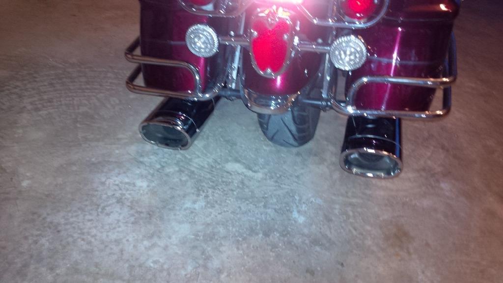

I also just scored a nice set of Monster Ovals. Price was reasonable IMHO, low miles on them and the only imperfection is a little rash on the bottom of the right tip (not seen when installed). So, I installed them on Saturday and took a 100 miles ride on Sunday. The verdict?? Well, both my wife and I love the looks and the deep note they produce, but agree they are probably too loud for our liking. I see that V&H makes 'quiet baffle' options for some of their slip-on's but a quick phone call to them confirmed no such option exists for these. So before giving up on them, I did some searching and found a thread here from a previous member who discovered an after-market baffle add-on that reduces the db level without affecting the deep sound. So I'll give that a shot.
Before...
http://i683.photobucket.com/albums/vv200/gnesvik/IMG_0085.jpg
and after...
http://i683.photobucket.com/albums/vv200/gnesvik/IMG_0089.jpg

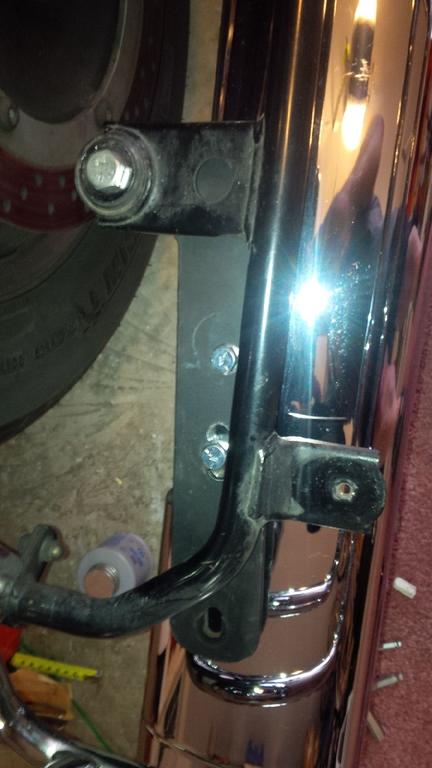

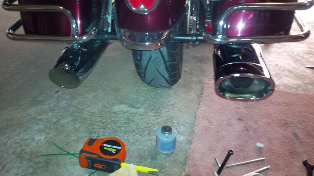

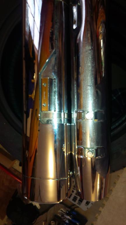

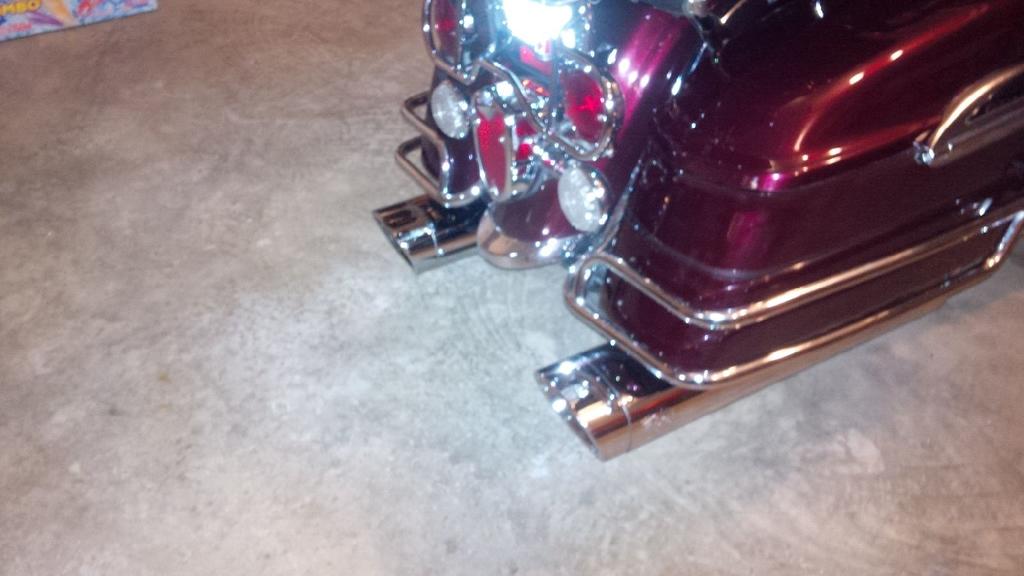

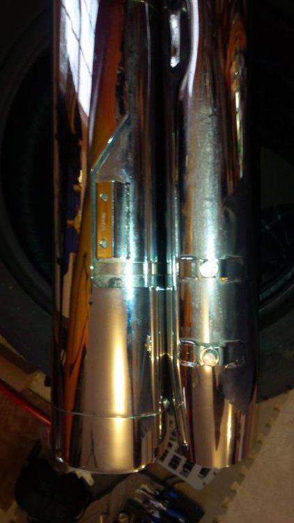

After receiving a bit of very good and well timed advice from Don(Aka: Freebird) yesterday :clap2: I was able to tackle and complete the install of the Monster Ovals. Had to modify my brackets made for the RK pipes and also rented a pipe extender tool to open up the front part so they would fit. Finished late last night and was only able to start her up this morning to listen. A bit louder than what I expected :confused07: but that was in the garage with lots of resonance. Can't wait to try them out tonight...:cool10:..will post a video in the next few days comparing the sound of the RK's to the MO's.
In the meantime, here are a few pics from the install....First one shows how the attachment points were different , next shows how I had to drill new holes in my bracket, then with one on to compare size with RK pipe and last 2 are with both MO's installed.

Well I know it took some work but I think they look fantastic. As for the mounting points, I would have to look at my RK mufflers again and I may be wrong but I think that your RKs were the issue, not the Monster Ovals. The mounting points on those look different than any I've seen before. Like I said though, I haven't looked in a while and could be wrong. Either way, great job and I look forward to hearing them.
