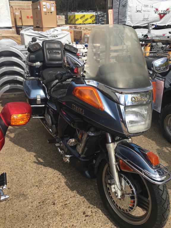

I picked up a 1989 Venture at an auction for $500. They said it didn't start and needed a battery. I put a battery in it when I went to pick it up and it fired right up. The guy at the shop was making faces that I bought it in the first place. I guess he saw the look on my face and started to back off of what he was saying. I think getting a running bike for $500 was great. What i'm wandering does he know something I don't. I didn't take it home because it wouldn't pass inspection just for a few small things, nothing major. It only has 33,000 miles on it and it looks like some upgrades. I plan on changing out all the fluids, new plugs, maybe rebuild the carbs, and the air ride doesn't seem to work. Looking at this forum it looks like people love their bikes, so knot sure why the guy said they were junk.

It was a running light out, dirty windscreen, and the throttle stuck a little bit. Pretty picky I think. The previous owner installed a CD player, back speakers, and back armrest. I'll take some pictures and post them.

Then start asking questions and be prepared to sort through the answers. From the first pic you posted I think it does look pretty nice and does have several upgrades I can spot right off. With those front disc covers you can run a tie wrap through each cover and it's disc in about three places on either side before you take the wheel off. The disc covers will hold all of the spacers in place so it's easier putting it back together. Does that front fender light and the disc cover lights work?

It looks like a real beauty that was obviously loved at one point in its life considering all the extras that have been added. As you have discovered there is a ton of information here and an awesome bunch of people that have been through every problem or issue you could ever have with this bike.
