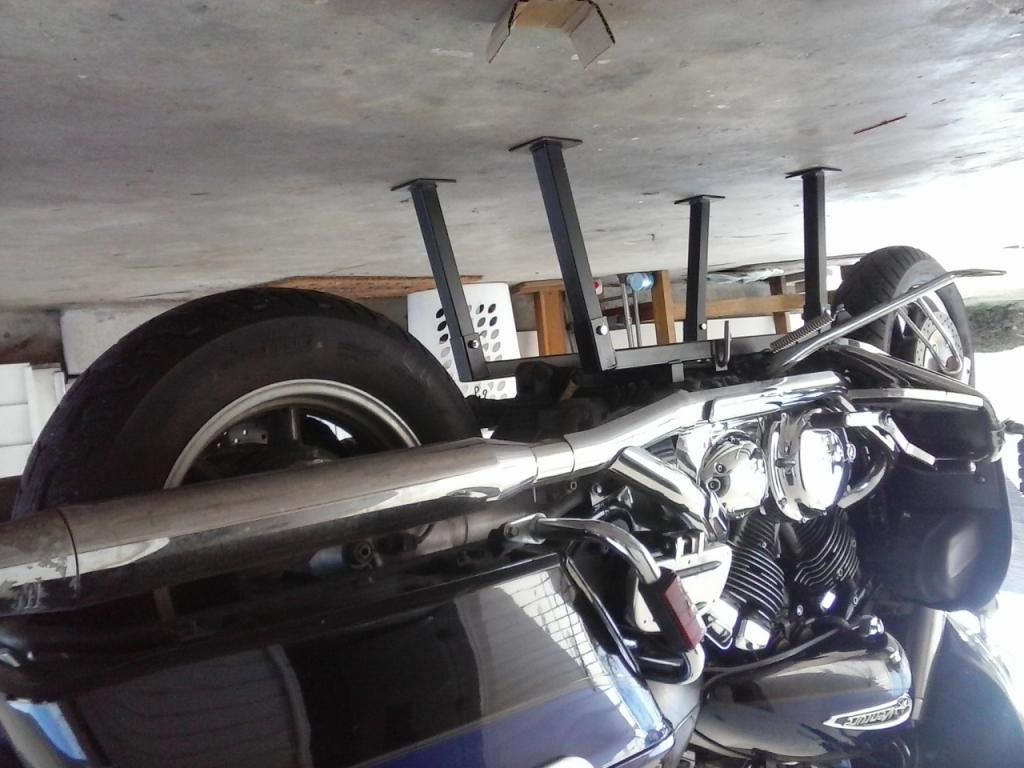

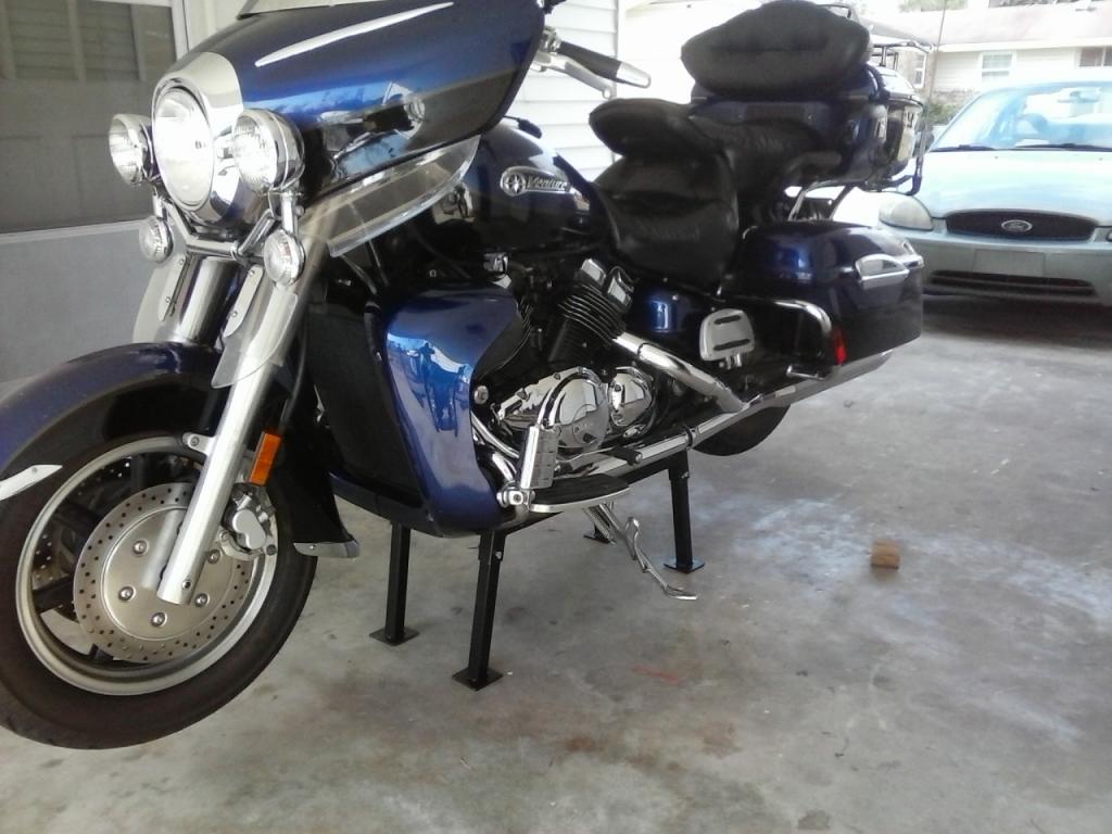

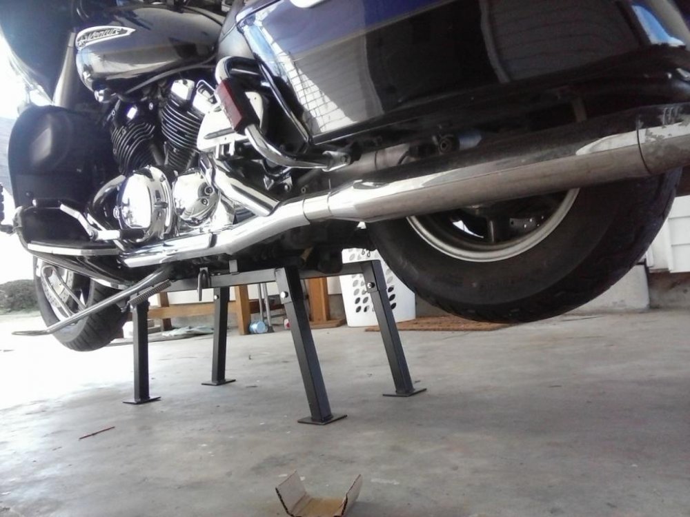

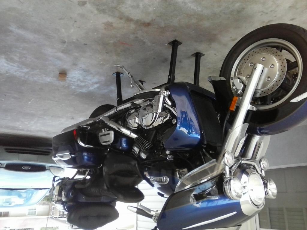

Larry1963 Posted January 27, 2016 Posted January 27, 2016 (edited) A couple weeks ago I bought a motorcycle lift for my RSV from Carbon One. First I guess because all the bad weather it took a week for him to get my check. Must be bad weather, but the lift arrived when he said it would. Here are some pictures taken with my crappy phone. I have had the lift for over a week it has either been crappy weather, work, or my loooooooooooong list of honey dos that have kept me from playing with it. Today's mission was to install it, lift the bike and put it on the legs of the lift and remove the jack. First is the bike up, the second is the bike from a better angle, the third is my dog back in side with me saying come on dad stop playing with toys and take me to the field so I can run and play. Ok just viewed this post, I do not know why the pictures are upside down. I went back to the computer and checked they are upside right on the computer. For you technical people what am I doing wrong. Ok thanks to the advice of someone here I went back to the photos on my computer and resaved them so they will hopefully be upside right Edited January 27, 2016 by Larry1963
SilvrT Posted January 27, 2016 Posted January 27, 2016 Looks fine to me ..... after I stand on my head! hahaha
Condor Posted January 27, 2016 Posted January 27, 2016 I wanna know how you got it to stick to the ceiling that way???
Larry1963 Posted January 27, 2016 Author Posted January 27, 2016 I wanna know how you got it to stick to the ceiling that way??? It was tough but me and the dog did it
Larry1963 Posted January 27, 2016 Author Posted January 27, 2016 I have seen other post in here about people having trouble with uploading pictures, what are we doing wrong
aharbi Posted January 27, 2016 Posted January 27, 2016 My stand didn't come with that option. Great for cleaning the underside and those hard to reach exhaust bolts ;-)
Larry1963 Posted January 27, 2016 Author Posted January 27, 2016 My stand didn't come with that option. Great for cleaning the underside and those hard to reach exhaust bolts ;-) Taking the picture I did notice a LOT of dirt under the bike.
aharbi Posted January 27, 2016 Posted January 27, 2016 (edited) Sorry couldn't resist :-) Depending upon the camera depends on the data captured and stored in the pictures Exchangeable image file format (Exif). This may include GPS coordinates, camera make/model, f stops, film speed, shutter speed, and orientation. Most computer picture viewing software will read the exif data and rotate it right side up. However it will not change the orentation saved in the exif data. The picture needs tobe 1) either rotated and then rotated back and resaved or 2) just resaved again depending upon the software being used. The software used on the web just "cares" about size not orentation and will display what is in the exif file. Hope this helps. Photoscape is a free and great Windows picture editing program you might try to size, rotate, crop, enhance, add text, etc. ps. The exif data is embedded within the picture file, and can not be edited seperatly, for the most part. Some picture editing software will allow it. Edited January 27, 2016 by aharbi
Larry1963 Posted January 27, 2016 Author Posted January 27, 2016 Well you get both views, upside right and upside down.
Larry1963 Posted January 27, 2016 Author Posted January 27, 2016 Sorry couldn't resist :-) Depending upon the camera depends on the data captured and stored in the pictures Exchangeable image file format (Exif). This may include GPS coordinates, camera make/model, f stops, film speed, shutter speed, and orientation. Most computer picture viewing software will read the exif data and rotate it right side up. However it will not change the orentation saved in the exif data. The picture needs tobe 1) either rotated and then rotated back and resaved or 2) just resaved again depending upon the software being used. The software used on the web just "cares" about size not orentation and will display what is in the exif file. Hope this helps. Photoscape is a free and great Windows picture editing program you might try to size, rotate, crop, enhance, add text, etc. ps. The exif data is embedded within the picture file, and can not be edited seperatly, for the most part. Some picture editing software will allow it. I went in and opened with another photo editor and resaved and it fixed it thanks

rougeray Posted January 27, 2016 Posted January 27, 2016 That had to be tough getting the lift installed on the left side of the bike. Meaning the bike will be on the kick stand which means it's leaning to the left. Laying down, holding the lift, aligning the lift with the center stand holes while fighting the kick stand then installing rod that attaches the lift to the bike. Much easer if rod is inserted from the right side of the bike. No kick stand to interfere with lifting, aligning then installing attachment rod. Just saying........
Larry1963 Posted January 27, 2016 Author Posted January 27, 2016 That had to be tough getting the lift installed on the left side of the bike. Meaning the bike will be on the kick stand which means it's leaning to the left. Laying down, holding the lift, aligning the lift with the center stand holes while fighting the kick stand then installing rod that attaches the lift to the bike. Much easer if rod is inserted from the right side of the bike. No kick stand to interfere with lifting, aligning then installing attachment rod. Just saying........ The lift stand goes on easy enough. Set it up there and put the pin through, with the bike still on the kickstand. Carbon One recommended that you put a 2x4 under the kickstand so the bike would be standing straight up. But who am I to follow directions. I just put on the lift with the pin provided put the jack where I want it and I grab the right handle bar and pull the bike straight up. and push with my foot the jack under it. My jack has a foot pump so while in that position, my holding the bike up, and jack away. I did not realize how height it was going to raise the bike. But when up in that position extremely stable, no fear of it tipping over. I am happy with this. The only down side I see, when I was looking under the bike, I can tell it hasn't had a good cleaning in a long time.....

Larry1963 Posted January 28, 2016 Author Posted January 28, 2016 Glad to hear you're happy with the unit. I've got one on the way and can't wait to get that RSV up! Looking forward to being able to get at different areas of the bike as the old knees don't allow the flexibility of earlier days. You will be happy with it. The only thing I could add, and not sure if it is even possible. If you could put some casters on the legs so you could move the bike around.
Rmar Posted January 28, 2016 Posted January 28, 2016 I have the carbon one stand am very happy with it as is. I personally think caster would allow to much movement when working on the bike for me. When I need move mine around I just jack it up a little and move it on the jack. Bike is stable while moving on the jack so no problem for me. Just my 2 cents.
Larry1963 Posted January 28, 2016 Author Posted January 28, 2016 That had to be tough getting the lift installed on the left side of the bike. Meaning the bike will be on the kick stand which means it's leaning to the left. Laying down, holding the lift, aligning the lift with the center stand holes while fighting the kick stand then installing rod that attaches the lift to the bike. Much easer if rod is inserted from the right side of the bike. No kick stand to interfere with lifting, aligning then installing attachment rod. Just saying........ Let me add one thing, in Carbon One notes he had a warning about leaving the lift part on the bike that pins to the bottom of the bike. I do not have his instructions in front of me but it said something about marking it or flagging it because it is possible to lower the bike and without the legs it is possible to forget this. Well I thought that was stupid, how could someone do that. Well........ I lowered the bike, and then got a phone call, which led to me doing something else, which lead to me doing something else, 4 hours later my wife is headed home, it is raining out so I was going to pull the bike back into the shed..... Well guess what I almost forgot to take off. I am going to get a remove be for ride or some kind of red flag to put on both sides or on the key when lift is installed. I suffer from serve case of CRS.
Larry1963 Posted January 28, 2016 Author Posted January 28, 2016 You are probably correct, yesterday was first time and it was really to see how great it was.
rougeray Posted January 28, 2016 Posted January 28, 2016 Let me add one thing, in Carbon One notes he had a warning about leaving the lift part on the bike that pins to the bottom of the bike. I do not have his instructions in front of me but it said something about marking it or flagging it because it is possible to lower the bike and without the legs it is possible to forget this. Well I thought that was stupid, how could someone do that. Well........ I lowered the bike, and then got a phone call, which led to me doing something else, which lead to me doing something else, 4 hours later my wife is headed home, it is raining out so I was going to pull the bike back into the shed..... Well guess what I almost forgot to take off. I am going to get a remove be for ride or some kind of red flag to put on both sides or on the key when lift is installed. I suffer from serve case of CRS. I have forgotten to take the lift off more than once. However if the rod is inserted from the right side of the bike the rod prevents the kick stand from fully retracting. At that point it's back off the bike to remove the lift. I'm not sure if Carbon One intended it to do this in his design or if it was just an unintended consequence. 😜👍🍻
Leftcoaster Posted January 28, 2016 Posted January 28, 2016 I appreciate the heads-up regarding the possibility of forgetting to remove unit before riding. It takes me back to my flying days and also gives me a solution. We had many 'Remove before flight' bright red flags to bring attention to crucial items such as pitot tubes, flap/aileron/elevator locks, etc. I plan on using the same attention getters for the lift unit. If I still forget, man I've got bigger problems than I want to admit! Like the idea of casters on the unit but I'm sure that Carbon One had thought of that at some point of production. Easily rectified by using the jack. Still praying for sun and dry roads!
Larry1963 Posted January 28, 2016 Author Posted January 28, 2016 I appreciate the heads-up regarding the possibility of forgetting to remove unit before riding. It takes me back to my flying days and also gives me a solution. We had many 'Remove before flight' bright red flags to bring attention to crucial items such as pitot tubes, flap/aileron/elevator locks, etc. I plan on using the same attention getters for the lift unit. If I still forget, man I've got bigger problems than I want to admit! Like the idea of casters on the unit but I'm sure that Carbon One had thought of that at some point of production. Easily rectified by using the jack. Still praying for sun and dry roads! I was in the Air Force, mainly a F-15 mechanic, hydro and fight controls. We had remove before flight tags on everything. Or red tags on switches. But you would still hear of a jet taking off and the gear would not go up, or the altitude would not read right because some dumbass on the ground forgot to take out the landing gear pin or cover off the side of the jet. Fun times had by all
Carbon_One Posted January 29, 2016 Posted January 29, 2016 Even I had forgotten about removing the adapter. Thus my warning in the instructions. On the rod I could have shortened it, but left it as is once I found out the side stand wouldn't close all the way. Consider it a backup safety. Larry
