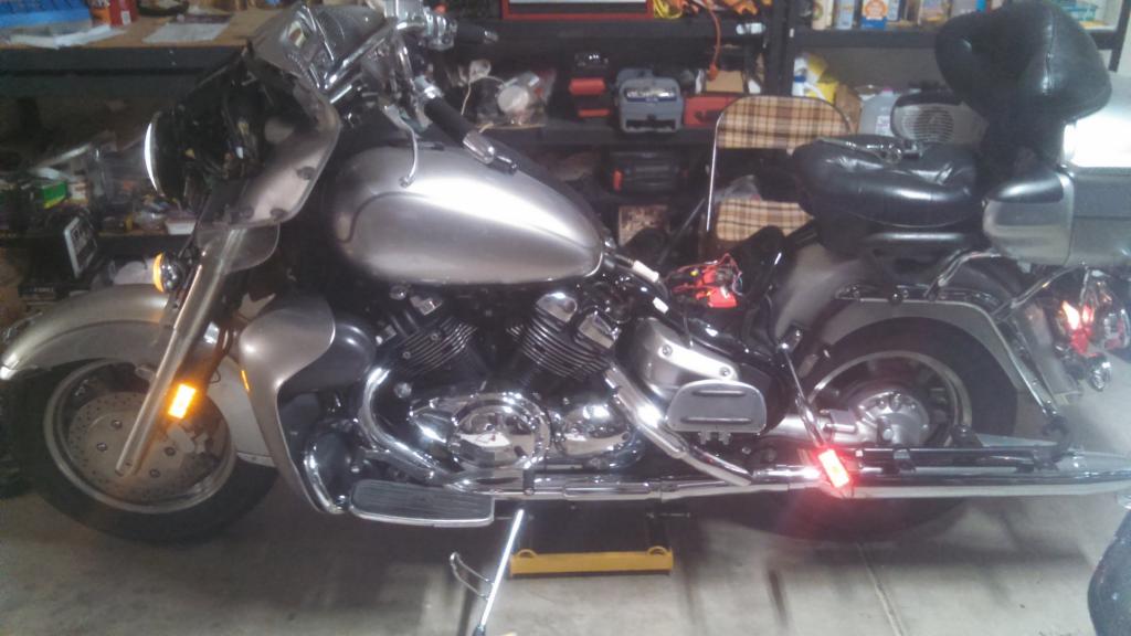

djh3 Posted November 23, 2015 Share #1 Posted November 23, 2015 I installed some LED strip lights Oh I dont know a year or so ago. I made brackets to go under the bags and those have 2 strips. One strip is running lights and one turn signals. So the other day I was checking things out and the one that is running lights is not working. So did the usualy , check ground (even though same ground for turn signals that still work) Power connectors etc. So do they but out? I thought they were pretty much a lifetime long thing. Also used some of the same strip up under the gas tank for back lighting and they seem dimmer than originally installed. The other side of the bike they are fine. Link to comment Share on other sites More sharing options...

djh3 Posted November 24, 2015 Author Share #5 Posted November 24, 2015 They were 12v and supposedly waterproof. No matter I have decided to install some LED clearance lights for running lights. One strip of them still work off the signals so for now I'm good with it. I probably should have just went this route to start with as they are brighter. I just had not heard of anyone saying their strip had died and thought it was strange. Link to comment Share on other sites More sharing options...

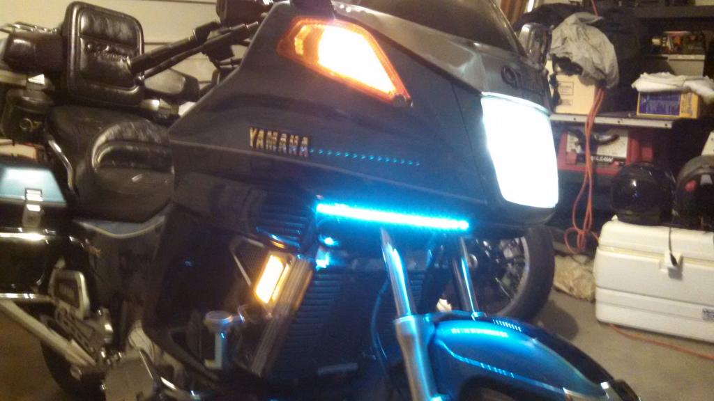

videoarizona Posted November 24, 2015 Share #7 Posted November 24, 2015 They were 12v and supposedly waterproof. No matter I have decided to install some LED clearance lights for running lights. One strip of them still work off the signals so for now I'm good with it. I probably should have just went this route to start with as they are brighter. I just had not heard of anyone saying their strip had died and thought it was strange. I am running LED clearance instead of reflectors on both Ventures. No problems so far. The LED strips I put under the fairing on the 1st Gen are still running despite rain and such...though we don't have much of that around here. Biggest problem I've had has been a minor annoyance. The power wires from the LED strips are tiny...and keeping them soldered to my bigger wires seems to be problematic with vibration. Just came back from a 400 mile run to Phoenix and around the area there and noticed I've got a headlight issue with 1st gen. Low beam is on but very low, high beam is fine. No warning from computer as it seems the low beam is on just enough to not trigger the computer. Weird! It's a Sylvania Ultra Star bulb. Lasted two years. Guess that's good. Link to comment Share on other sites More sharing options...
djh3 Posted November 24, 2015 Author Share #8 Posted November 24, 2015 I am running LED clearance instead of reflectors on both Ventures. No problems so far. The LED strips I put under the fairing on the 1st Gen are still running despite rain and such...though we don't have much of that around here. Biggest problem I've had has been a minor annoyance. The power wires from the LED strips are tiny...and keeping them soldered to my bigger wires seems to be problematic with vibration. Just came back from a 400 mile run to Phoenix and around the area there and noticed I've got a headlight issue with 1st gen. Low beam is on but very low, high beam is fine. No warning from computer as it seems the low beam is on just enough to not trigger the computer. Weird! It's a Sylvania Ultra Star bulb. Lasted two years. Guess that's good. Boy you got that right. I too soldered tiny wires to the LED strips. They get so brittle and break off soooo easy. Last night while working on the running light part of the right lights it broke off twice. Being I was adding the clearance lights anyways I just skipped it and didn't hook them back up. Link to comment Share on other sites More sharing options...
