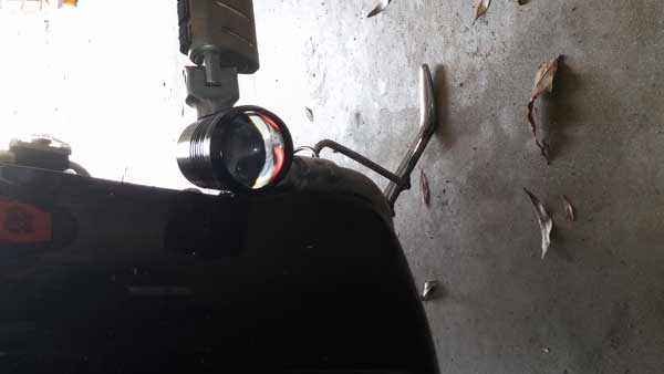

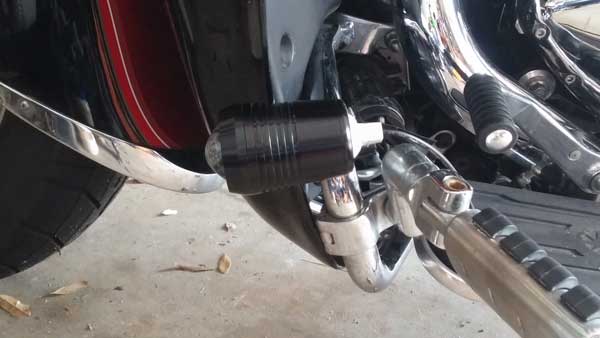

ragtop69gs Posted September 8, 2015 Author Posted September 8, 2015 It's all installed, no relay, we'll see how it does. Pics to follow.
ragtop69gs Posted September 8, 2015 Author Posted September 8, 2015 http://images.tapatalk-cdn.com/15/09/08/b8ab64a1ed6e6fa0399326e42a036f57.jpghttp://images.tapatalk-cdn.com/15/09/08/0f62dee63b33af48ba22e8f0d45f9da6.jpghttp://images.tapatalk-cdn.com/15/09/08/bbacb75d86d62fefb7088db53e25ef6b.jpghttp://images.tapatalk-cdn.com/15/09/08/290e08d5a50a120f9d71b1b5bdb9c0ab.jpg
djh3 Posted September 9, 2015 Posted September 9, 2015 Man those remind me of some aircraft Taxi lights I had installed many moons ago. They were on a GS1100 Suzuki and if you turned them both on at same time I think it slowed the bike. LOL Those are looking sporty. Almost same idea I had.
ragtop69gs Posted September 9, 2015 Author Posted September 9, 2015 They throw some good light even adjusted pointing down low. They are both flood 20* floods, I'm going to replace the left one with a spot beam. $20 a pair off ebay, 1500 lumens 18 watts Not sure what happened with the pics posting sideways
