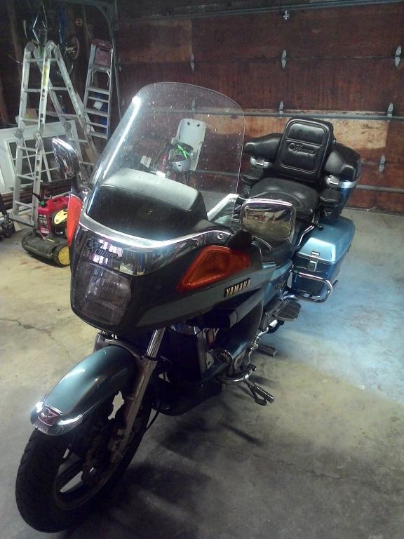

MrOflam Posted August 10, 2015 Share #1 Posted August 10, 2015 Hello! New to the forum, looking for some help. Just bought a 1987 xvz1300 about a month ago, and I have noticed after riding a while, at slow speeds going through town with a lot of stops it gets pretty hot.... Temp gauge gets up real close to the red area (have not seen it actually get into the red though). Once moving and getting air flow it goes back down, into a range I would assume is much more normal... So Im wondering, what am I looking at here? New thermostat? Maybe water pump?.... Im rather new to bikes in general, so Im sorta taking stabs in the dark here. Any ideas would be awesome! Thanks! Link to comment Share on other sites More sharing options...
Flyinfool Posted August 10, 2015 Share #2 Posted August 10, 2015 Welcome What you are looking at is perfectly normal. That is just the way Yamaha set up the gage on this bike. Most all newcomers have the same concern. Mine runs on the edge of the red whether it is 70° or 100° out there. At 10° it will run lower...... The fan should turn on just below the edge of the red, drop the temp some and cycle back off. You can test this just idling in the driveway. We have some rules on this forum. We all love to see pics of bikes, especially new to you bikes. Don't let that @cowpuc character catch ya posting without pics, he aint far from ya is is just liable to ride down there to take pics and then take you and make you eat hot dogs....... Maybe even ice cream..... Link to comment Share on other sites More sharing options...

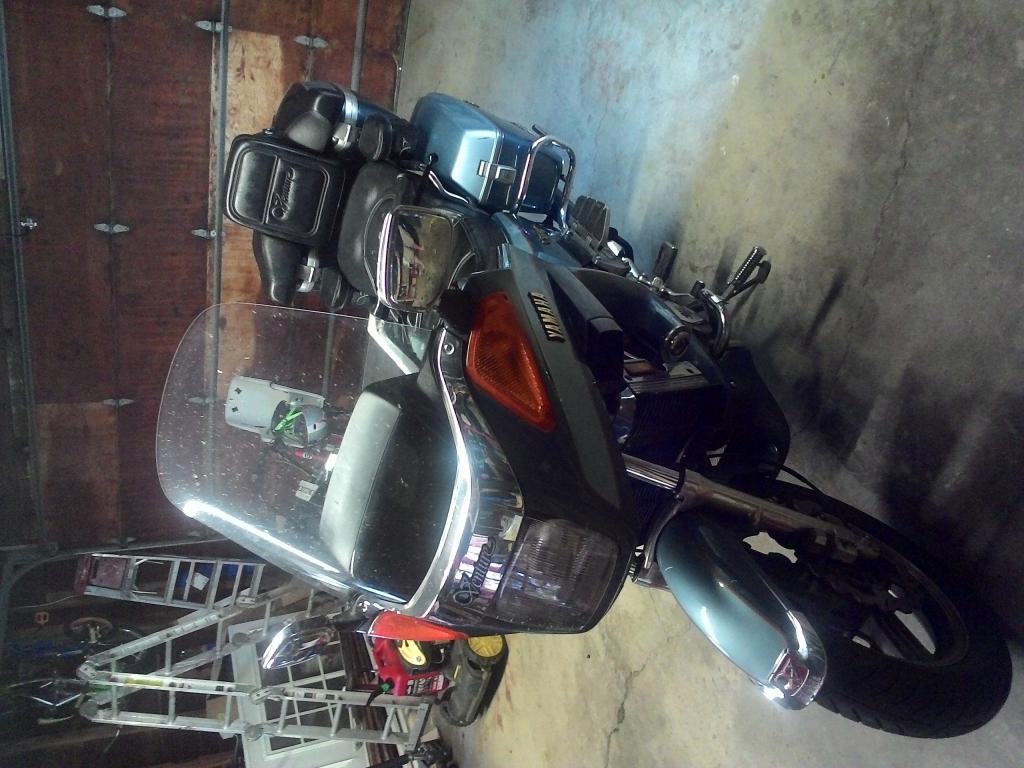

MrOflam Posted August 10, 2015 Author Share #5 Posted August 10, 2015 Awesome... This forum is more helpful than I thought it might be. The fan does kick on when the temp goes up, and I shall look into those other tips posted, thank you so much... As for pics, I only have one at this moment... And its not actually that great of one, but here ya go. Link to comment Share on other sites More sharing options...
